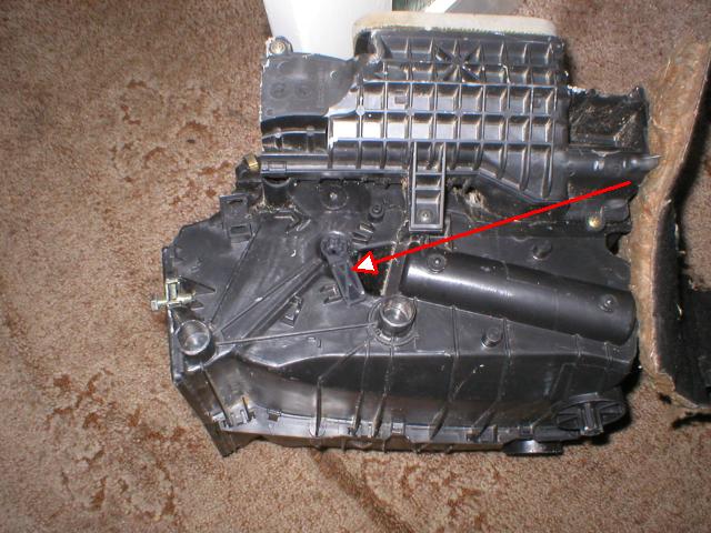

The flap is motor driven and with the motor in place with its reduction gearbox it is almost impossible to see where the flap is. You may be able to see the flap extension arm (there for non-AC cars to attach a control cable to) if you squint past the motor shown in Clogzz's post with a mirror but you'll be lucky. If you can, the end of the arm will face toward the front of the car when in the fully hot position. It arcs around roughly 6o degrees between cold and hot.
This picture of an early MK1 heater box upside-down and removed from a car for clarity helps to show there the extension arm is. It is shown in the fully hot position here...
Have you checked the water pipes to the matrix are getting nice and hot? More often than not, a cool heater is caused by either by an air lock in the matrix pipes, a silted-up matrix or inadequate airflow caused by leaves in the intake or a blocked pollen filter. The flap itself is usually fairly reliable.

Re: Xantia heater
Thanks citrojim. I could not see the picture of the heater in your post.
Also can you explain where exactly the input line to heater matrix is, so that i can feel the temperature. Or any picture that you can show me for the same. Do i have to go under the bonnet to reach it?
