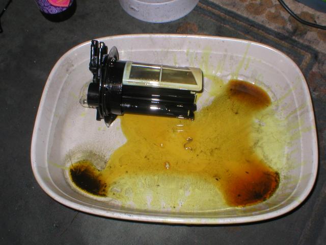

As a treat for her today I changed her LHM which looked more like best bitter rather than Vulcan's blood. It was manky in the extreme!
I also found more past butchery. Pulling out the filter head from the LHM reservoir the D shaped filter fell off. Closer inspection showed a lump of plastic missing from the level float tube, cracks all over it and a missing 'S' clip to hold the filer in place.
The missing clip and bits of plastic were found in the bottom of the reservoir.
Luckily I had a nice spare head and that's now been fitted along with nice bright new LHM.
This was the colour of the LHM
The black bits in the tray are from outside the reservoir and not from inside thank goodness...
Just as I was about to bleed the brakes Owen (Trooper30) called round to see me. He gave me a hand to bleed the brakes and was astounded by the horrible LHM bled out... Thanks Owen for your help today!
It may be subjective but I'm convinced Rattiva rides even better on new LHM
