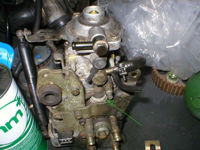

I need to establish whether i have a Lucas or Bosch pump. Is it easily identifiable?

If it's a 1.9TD almost invariably you'll have a Bosch pump which is OK...
If it looks more or less like this:
It's a Bosch...
Sorry for the poor picture... It was taken sans armour to show the location of the stop solenoid...
A 2.1TD will have a Lucas pump and that's right out for veg, even bio-diesel. Generally only the early non-turbo 1.9 diesels had Lucas pumps...
