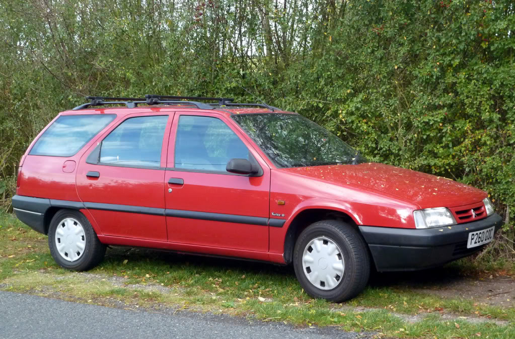

My son Richard has taken my 1993 ZX TD Aura hatchback to use while he saves up to buy himself a new car, so I decided to buy myself another ZX diesel for the winter to save my Visa from use on salty roads. I have bought a great 1996 (P) ZX TD Avantage estate with just 2 owners and 84,000 miles, it has come with full service history and the original sales invoice.
Richard has been complaining about an oil leak from the Aura so he came over on Thursday and we diagnosed it as head gasket. He now has taken my estate and called me from Forfar, Scotland Friday night to say it runs very well!
Fix the Aura or find another ZX diesel is the question?
