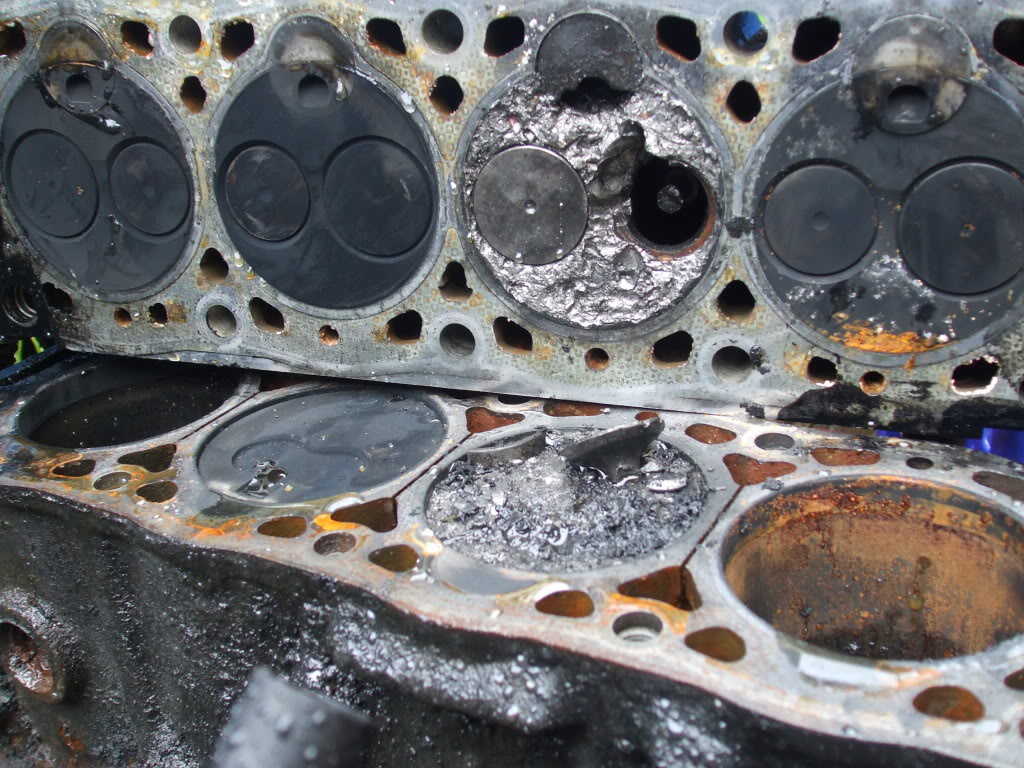

I'll post up a photo of the old engine which I have taken the head off to see what damage there was. You may be supprised how much damage a broken valve causes to the piston and head.

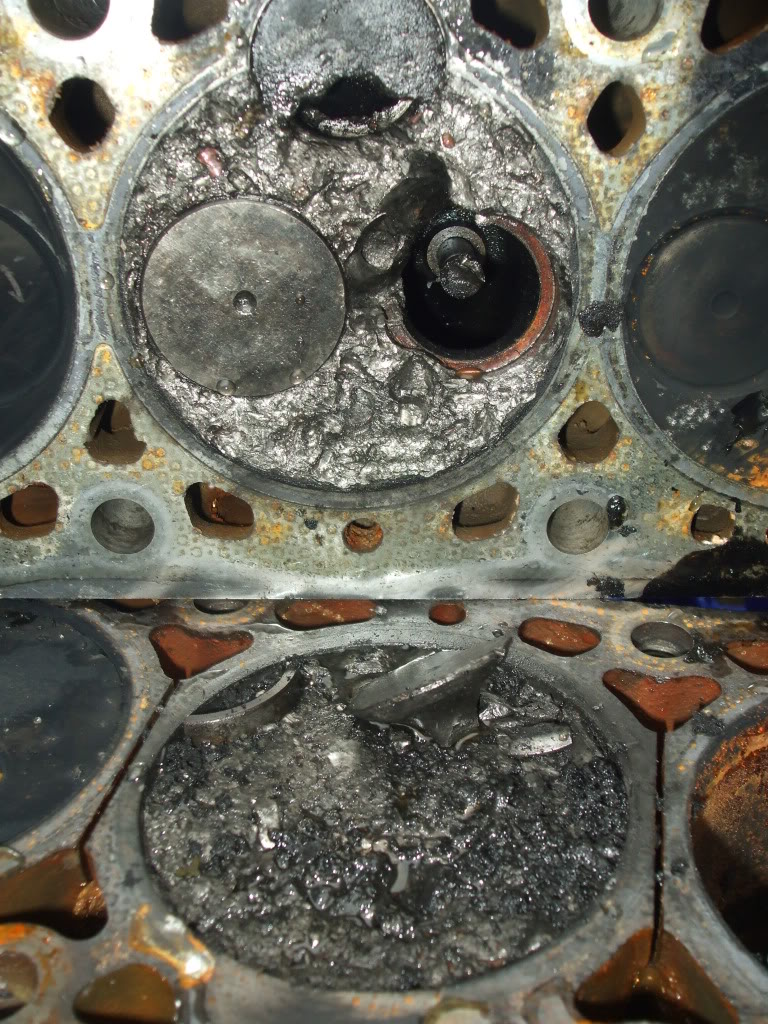

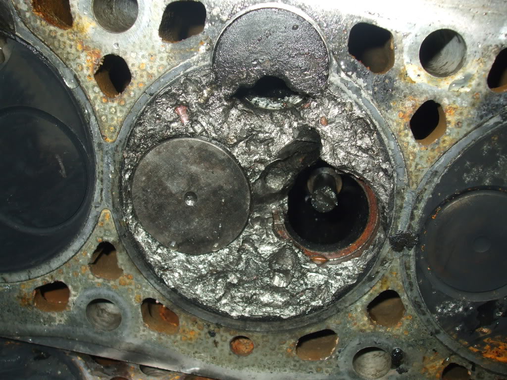

A couple of photos of the head and piston.
Quite funny really before I picked up the van he said it was running but SMOKING TEE HEE,after he got it towed home he said it wont turn over anymore DOH.

Do you think I should use solvolautosol or T cut :lol:
You may notice the injector inserts are loose as well the one on the left is protruding from the head,I stuck a srew driver in and wiggled the 2 outer ones out.
