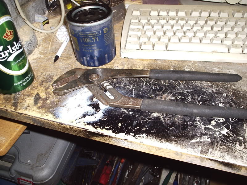

Quick stubborn oil filter taker offer tool tip:
(yeah, I know that don't sound right, just these painkillers + beers = mild headspin :lol: )
Get yerself some of these - plumbers wrench? Had mine for years. I've tried em all over the years, ,(filter looseners),ratchets,chains,screwdriver thru it,(btw,that is a good one on stubborn filters :wink: )
and believe me, I've changed a fair few oil filters
but this tool,for me anyway,is my favourite.Even in tight spaces,(my Mundano filter was round the back,twixt bulkhead,but you could just about loosen it,then spin it off by hand ; )

Careful Dave, don't get those tins mixed up.. Drink from the green one, not the blue one :lol: :lol: :lol:
Well done :D It's horrible working in the wet with a dodgy back, good on 'yer - you deserved that tin of Denmark's finest!!! (even if it was brewed in Northampton...)
