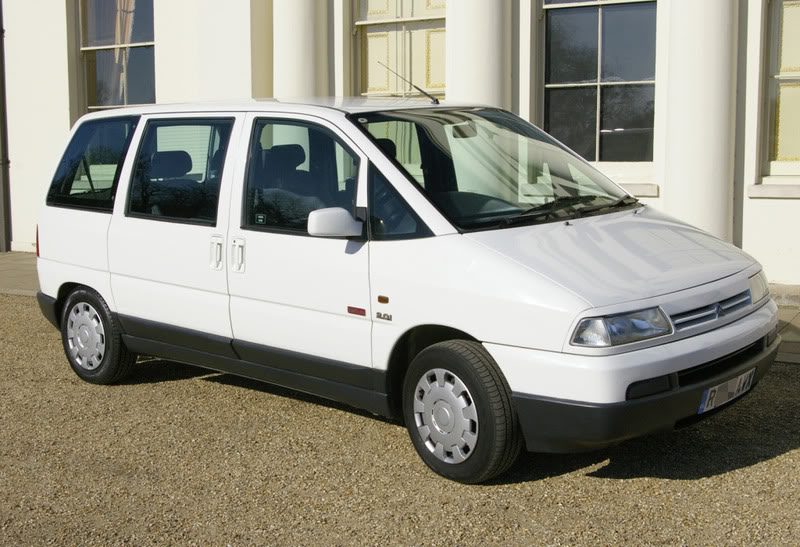

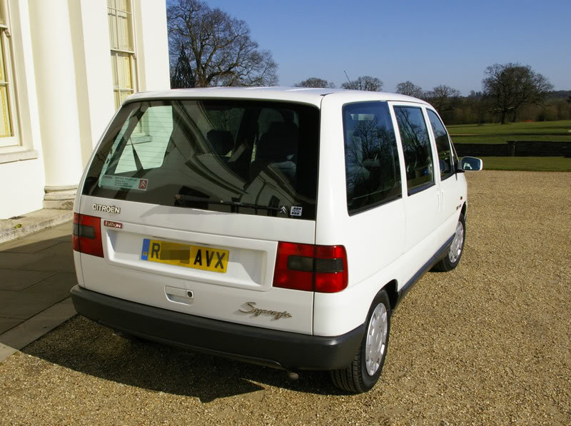

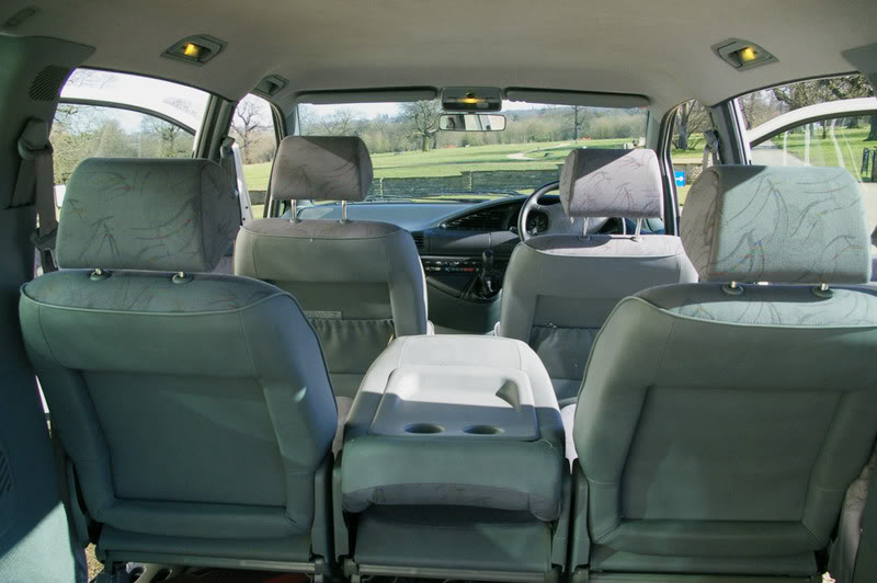

I sold one earlier this year...

Nice pics! Wish mine looked like that. I've done 40,000 miles in mine over the last 4 or 5 years and it's 11 years old. No gearbox problems, although can take a bit of effort to get it into reverse sometimes. The gearbox will depend on the engine type, it could be your gearbox info is for the 2.1 TD or the HDi model.
