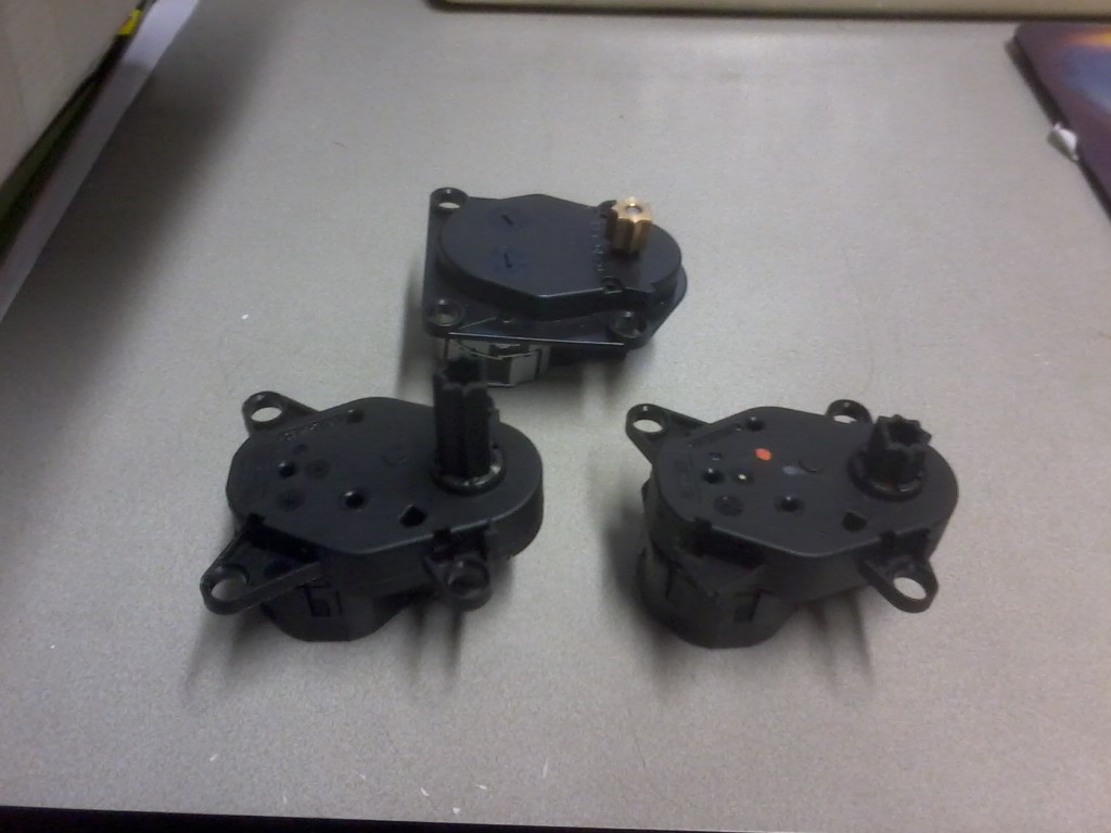

Correct, its the mixing flap. If you look at the picture below you will see the 3 different motors available. Bottom right is the still working but useless motor that no longer binds with the mixing flap. Top middle is the Citroen revised part when they realised there was a problem. Bottom left is the cure if its too late for the brass geared motor. Note the extra long gearing on the part you need, its this that goes deeper into the heater box to mesh with the mixing flap.

The cure is actually to remove the resistance. This involves dismantling the heater box completely - which in many vehicles will require cracking of the airconditioning.
From my observations, I believe the motor drive fails because of excessive load; this is caused by the plastic flapper itself binding on the guts of the heater box.
The heater boxes seem to become slightly distorted with time and use; hence the problem worsens until failure occurs...
