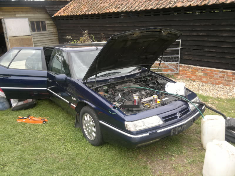

Ok, so as most of you guys will know I had Jim's XM V6 off of him.
Now as we all know its not like Jim to back down from a challenge but certainly I can see why he did, its a complete mare to work on in comparison to the Xantia, and Jims reporting of the xantia v6 being well thought out and the XM being a friday afternoon car is bang on the money.

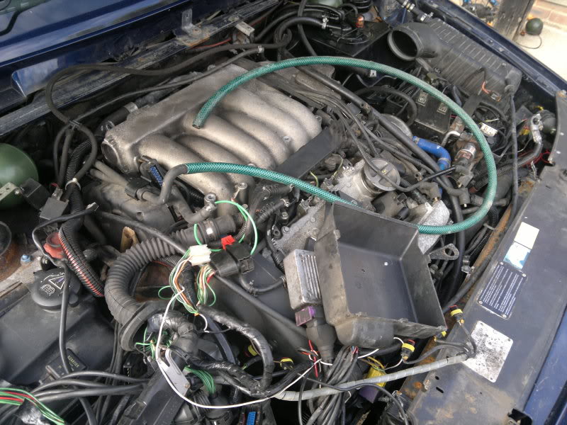

I've not done much with this yet but start to get started, if that makes sense i hope....
So, so far, i've started to remove the inlet manifold as i figure that will give me better access to the back of the engine... i've drained the oil, jim left the collant drained (saved me a job) and i've got all the petrol out (although the gauge still reads 1/4 but the pump can't pump anything more, a job for later methinks)

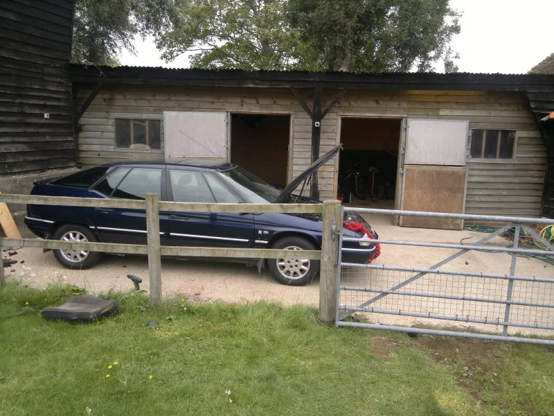

And the XM in it's cage

Unbelievably congested in there.
Best get some proper hand massage booked up.

Chris do you own a dersh (2CV ) with those two horse stables in the back ground :twisted: :shock: :lol: :roll: :wink:
regards malcolm
Posts: 55168
x 8436
citronut wrote:Chris do you own a dersh (2CV ) with those two horse stables in the back ground :twisted: :shock: :lol: :roll: :wink:
Hay, hay...
Neigh lad, he got himself saddled with quite enough being the custodian of an XM :lol:
I just hope he's not flogging a dead horse there and that he's got the stable door shut in time to save her...
One occupant of those loose boxes was called 'Crunchie'. Sounds like a bit of a description of the strut tops rather than the name of a horse...
