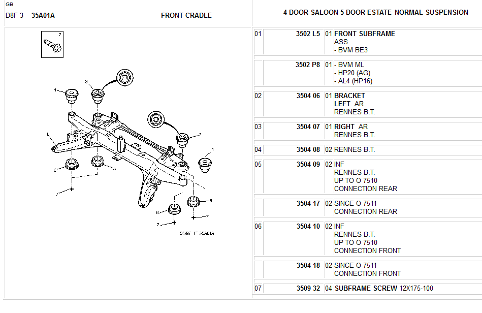

One last thing - anyone got a diagram of the front and rear suspension so I can see the general layout and bushes etc

Regarding suspension, as you say 1.9TD its older shape so that's D8:
I don't appear to have *any* rear suspension / body etc diagrams at all for some reason for any 406 and very little front. Obviously there's wishbones etc too.
There's not a there really though at the back.
Favourite issues are probably the rear droplinks or the arms (arms will give movement in wheels and cause odd tyre wear) , take care when changing as eccentric nut for camber.
