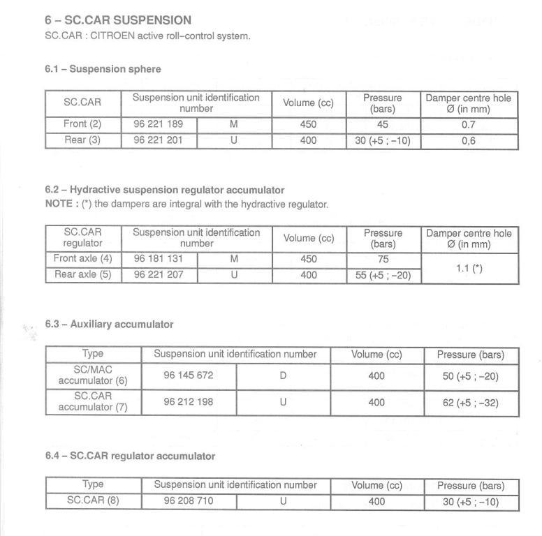

Mike,
Here's the official Activa Sphere table:
The Activa balancing Sphere (Called the SC-CAR Regulator) is a conventional block mounted sphere whereas the Activa Accumulator looks like the Anti-Sink, hence grouped together...
A weak main accumulator can often be found to use as an Activa balancing sphere as it's quite lowly pressured at 30 bars...
So, you have a Technosir? Excellent, I'm envious
You'll find a big difference once all the spheres are good, Activas are very critical of sphere pressures.

For a more detailed sphere chart including the size of damper holes look here then click "Technics" in the left column followed by "Technical Data" followed by not surprisingly "Sphere's"
