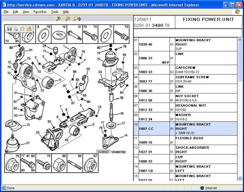

DHallworth
- Posts: 2437
- Joined: 20 Nov 2005, 17:05
- x 162
It's part number 1 in that picture.
Part number is 183946 and it currently retails at £28.18 including VAT from the dealer.
Ours made a clank when you started the engine and made the same clank when you changed gears. To visually inspect in situ ours looked absolutely fine, when removed from the car the rubber insert basically fell apart.
David.
