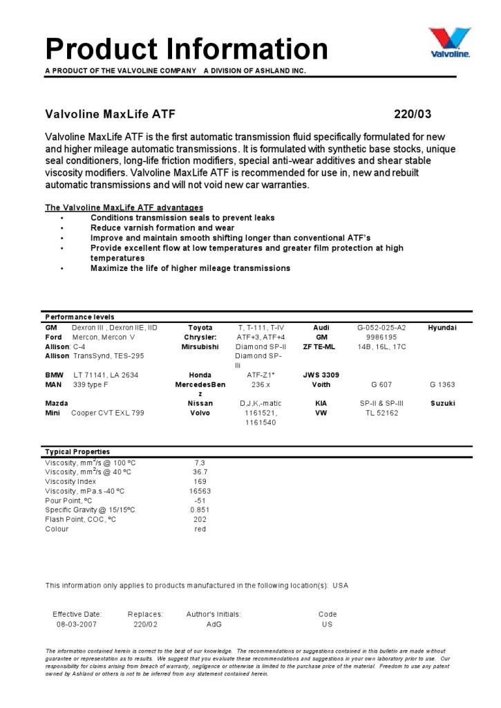

i put Valvoline Maxlife into my 4HP20

dieselnutjob wrote:Lots of oils say that they are equivalent to LT71141 but the fact is that ZF only recommend the original Esso oil and not anything else. I don't know about Seimens so you need to check that yourself.
Personally I only put the real oil, as specified by ZF in my 4HP20. I won't risk saving £40 on oil to put a gearbox that would effectively right off the car if it fails.
I don't think that LT71141 is a spec, it's a product name, so when another oil manufacturer says that their product is equivalent I take that as being virtually meaningless.
I could be wrong though, but if I am wrong all it's cost me is £40.
Assuming we are talking about vehicles that are out of warranty ? I too might have a punt at an equiv' (cheaper oil ) - or maybe not ?
