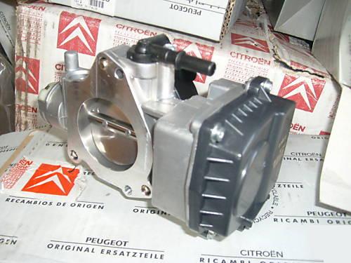

If the 407 is like the petrol C5, start by squirting the motorised throttle spindles, then unplug the EGR valve, item 1 at top.
The display will soon say anti-pollution fault and after reconnection mine took several weeks for the fault indication to clear.
No throttle sensor, a pedal sensor only and made mostly of two magnets with nothing to go wrong, and sitting under the fuse box in front of the master cylinder.

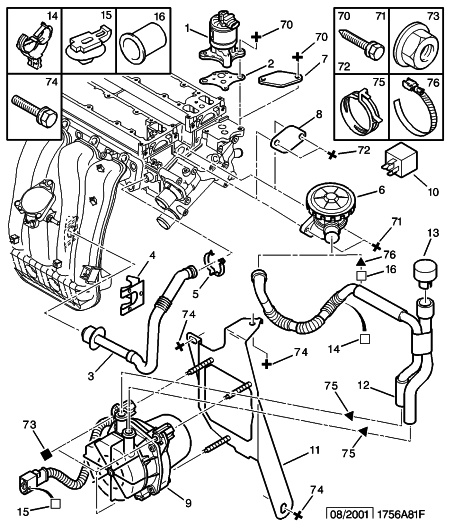

Thanks Clogzz, but some explanation needed fm you.. :?
Squirting motorised spindle (no. 8, below pic) with WD40?? contact cleaner??
& unplug EGR (no. 1 electro valve, below pic), then re-plug the EGR or leave it out ??
cheers[/img]

Sorry, I should have explained that properly. :oops:
The EGR valve should be left unplugged while driving to find if it affects the delay.
I squirt with WD40 because I’m stingy but carburettor and contact cleaners are better.
I’ve bent the tip of the squirting tube so as to squirt at an angle.
I got some benefit from also squirting the spindle from the outside behind the throttle return spring.
Nothing of interest inside the plastic cover, there’s the throttle motor with no access to the spindle.
