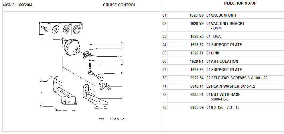

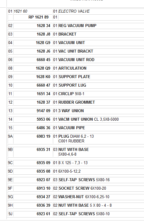

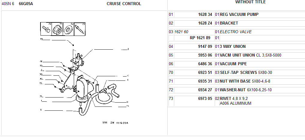

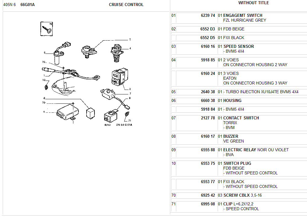

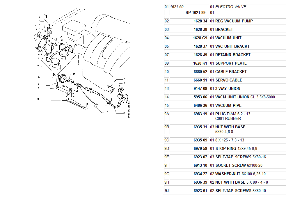

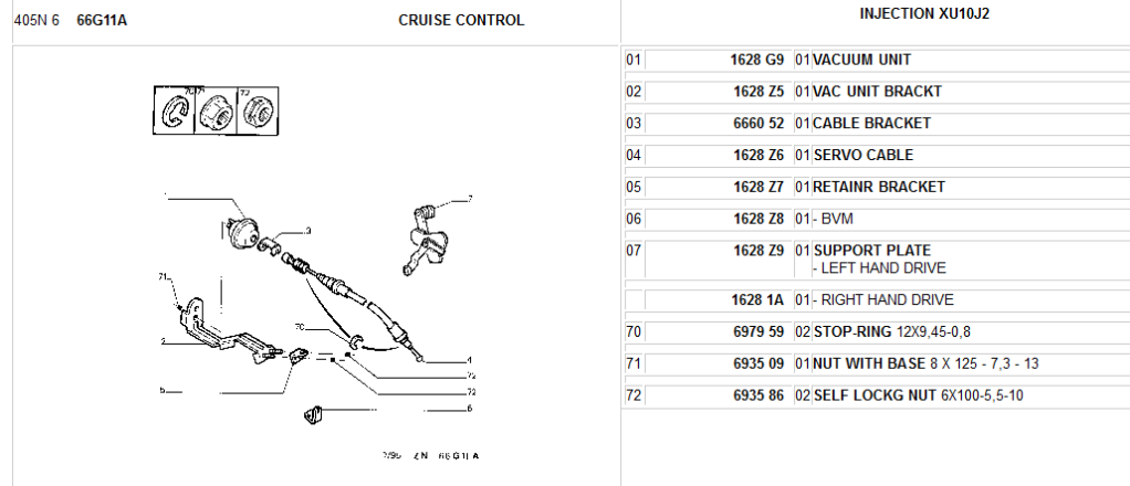

OK, please read description above each pic carefully ;) although I've tried not to mix them up :D
405F (up to 1993) General components:
405F (up to 1993) I think 8v units only, components:
405F (up to 1993) I think 8v units only, key for above components:
405F (up to 1993) Another layout (slightly different) 16v units, sorry about pic quality, very similar to the above though:
405N ( 1993 onwards, "single" dash ;) ) , there's only four diagrams, not a lot of help:

Wow! Thanks very much for that; it allows me to cobble something up which looks OEM. The bracket 1628J7 is all I really lack...
