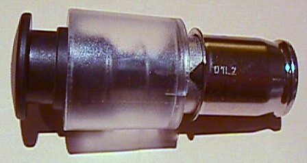

Tried to use my Garmin satnav today via the cigarette lighter power supply. When i pulled the lighter out there appears to be a clear plastic sleeve with several cracks in it attached to the lower half. Is this sleeve supposed to stay in the trim piece around the gearlever or is it correct in coming out with the lighter? Either way the satnav plug isn't deep enough to reach into the socket to provide a supply. #-o

Based on experience with a Xantia, that plastic sleeve is NOT supposed to come out.
Once it is broken, there is a high probability that attempting to plug anything into the socket will cause a short-circuit and blow the fuse.

C5 lighter with sleeve at top.
The rear socket has a shorter reach.

Your lighter looks remarkably like mine does and my socket still works fine.
The problem with the socket is finding something that's slim enough enough to reach far enough down to make a contact... most power supply plugs are to short in length, to broad at the shoulder or both.

The cigarette lighter in the picture looks fine to me.
There is also a dc socket towards the rear of the centre console which is much more suitable for plugging in accessories. as you say the cigarette lighter socket is much too deep for most plugs.
