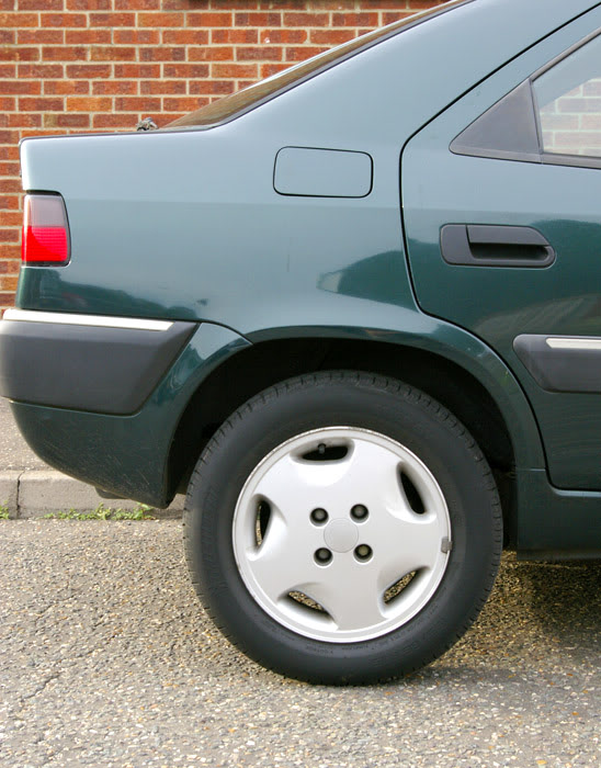

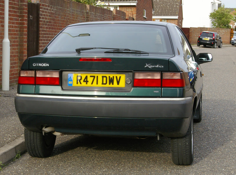

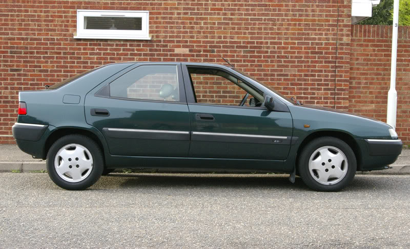

Work carried out thus far (by my trusted Citroen specialist) is pretty extensive, including regassed rear spheres, new accumulator, new rear height controller plus anti-roll bar linkage and dog's bone (all from Citroen), a new high pressure pipe to the controller and a general health check.
It's also been Lexia'd by Sir Jim (it was he who pronounced the old height corrector fubar too).
BUT
I still rides too high at the rear and feels a tad hard still. The sports mode button does make it harder, so it seems to be 'almost there', but not quite. I have the car booked in for an MOT on Thursday, so will get the ride height looked at again before that. Another thing is the anti-sink function seems to 'stick' and when I start it up in the morning it drops with a harsh thunk before rising up to normal (insofar as the lever's at normal)...
any advice? (Like can the ride height be easily fine tuned?... are there other issues that might be causing the problem like doseur valve?)

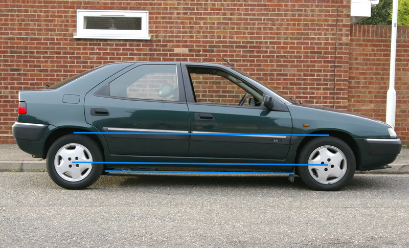

Here are some pics. You'll see from the image with the blue lines on it, the car generally seems (to me) a little high, with the rear about an inch and a half to two inches too high in relation to the front...
This must be sorted soon, as it's driving me nuts.

It does look a little high at both ends.
When i had similar problems i used the method Sir Jim described to me but it does need a pit/ramp to be done.
have the car running and in normal height mode and loosen the ARB link. The car will sink once the ARB link is slack enough.Now put the car into high and when it settles the ARB link will be pretty close to its max position.Tighten and set to normal height.
I know its not very scientific but it does leave the car pretty close to where it should.
Im sure Jim will refine the explanation but you really do need a ramp/pit to do it as it makes life easier and most pits/ramps are level

Bout 4inches too high. What a nice Xantia.............I still love green ones.

Definitely second the need for proper ramps or a pit.
With Cassy I slackened the clamp on the rear ARB and rotated it using a flat screwdriver until there was about a finger's width between the top of the rear tyres and the arch (don't use your finger to check, us something the same width just incase she drops - or use a neighbour if you don't like them) then tightened the clamp, did some citrobics to make sure it was all right and job done.
Ride is much better.

I agree that the rear height is much too high, and this will cause a harsh ride.
Get the height adjusted, and then come back for more advice it is still not riding smoothly.

Just a thought... If the height corrector has been replaced, maybe the linkage to the height control lever is wrongly adjusted, rather than, or as well as the roll bar clamp adjustment. My confidence in your specialist is slightly diminished.
