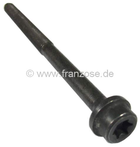

Could not find a picture easily ! , although these sort are the ones you're after:
Note that's probably not an XUD bolt, but that style of head.

female torx bolt, mine are currently male torx but does it matter i suspect not.

I think just the head is different, although the first link is like the pic I posted and the same as I fitted to my 205. The second link look like DW8 ones, but I've not seen a Citroen XUD for ages (years) so not sure.
Andy.
