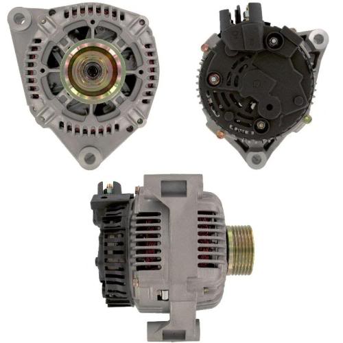

Here's pic of alternator. You can see where the 2 long bolts are:
Alternator type code is on the sticker but if it's unreadable then I 'll give the code from mine which might be same.
Valeo A13V1101 , It night be helpful when you have to check from cross reference tables.
As I told in earlier thread mine was changed. The hydraulic pump was not removed (for sure) neither the air conditioner compressor.
I think (almost for sure) the aux belt tensioner was removed.
PS: check pm.
Edit: Checked alternator pic from service pages. I think I know why the tension roller was removed. It is right in front of the lower long bolt.
I am afraid you have to move the upper roller as well which is in front of the upper long bolt
I can add that pic if you don't have access.
