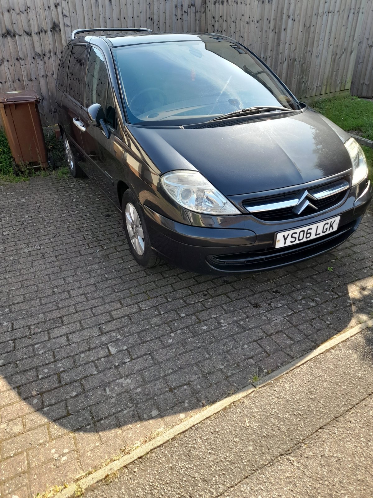

Ive just done my C8s 2006 suspension. What a biatch!!!! First I damaged myself undoing the bottom strut bolts and then damaged myself whilst undoing the link rods as it rounded itself off. Out came the grinder, off come the link rod. Strut came out easy. On went the spring clamps, off came the spring clamps
that hurt. On went the clamps, off came the old spring. Compressed new spring with clamps and was 50mm short of the compression needed to fit top hat, spacer and nut. So second set used to get compression needed. After that it was a simple job of reinstalling strut and jacking up brake disc so link rod could be attached to strut and tension bar.
if your thinking of doing this job, your crazy!!!!!!!
