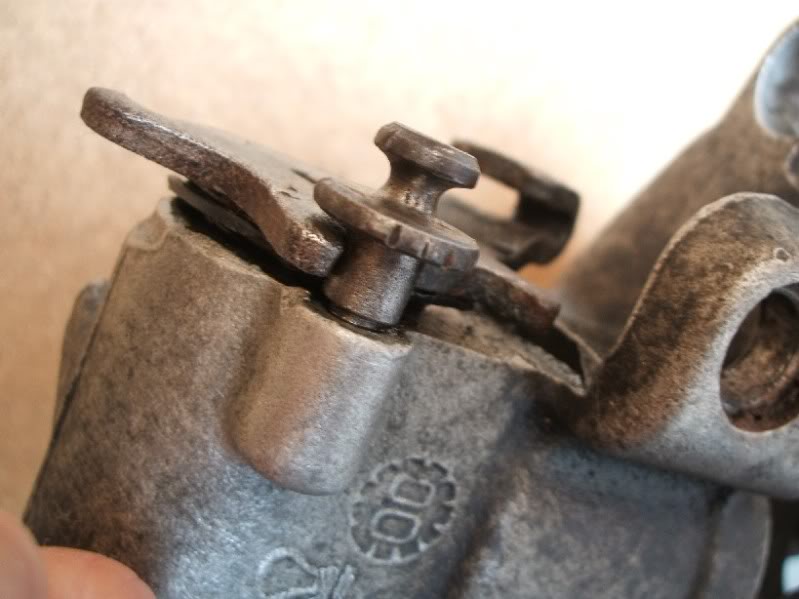

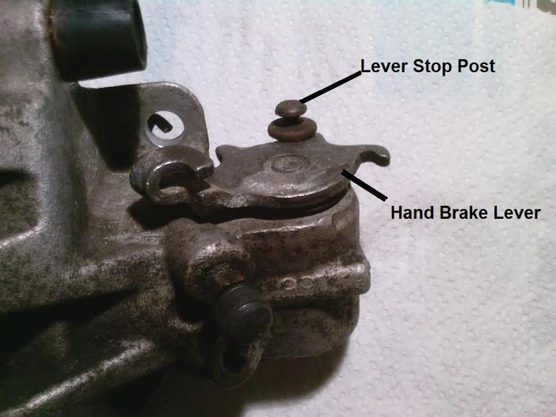

I need to strip the rear caliper down to renew the seal on the handbrake actuating lever, but I'm stuck as to how to remove the Lever Stop Post, this has to come out so that the actuating lever can be removed.
As you can probably see from the marks on the stop post I've had a go at it, I heated the caliper area & the stop post until it was hot then tried to unscrew it with a small pair of Stiltons but it wouldn't budge. I'm now wondering if the post is pressed in. As you can see the area of the caliper that the post goes into is a lug on the caliper, I really don't want to break this off the caliper.
Would any of you knowledgeable chaps have any idea how this post is removed from the caliper.

well it looks like someone has tried the molegrip aproch,
i would think it either unscrews or drifts out,

Same here. Maybe if you could get better purchase/grip on it, ie bigger moleys/stillsons/leverage etc?
Would it ruin the stop post if you filed 2 sides of the bottom/larger ring flat, to get a spanner on it, and then a quick tap with a lump hammer to crack it?
Looks old, shame you can't just nack it, ie cut the top off and drill the rest out.

I had the Stillsons on it & was pulsing the pressure to try to budge it, I also tried tapping the top of it with a small hammer as I held the pressure on but still no joy.
I actually bent the post a little in my attempt to loosen it. I'm scared to use to much force in fear of cracking the lug on the caliper where the post is fitted to, as you can see it looks very prone to cracking off if you get it wrong!
I thought about sawing through it then drilling it out, I would then make a new post from a bolt or something, I have a friend with a Lathe so I'm sure I could rope him in to knock me something up.

There's no visible thread traces on the bottom end of that hole, nor on the shank.
I'll suggest it's splined (maybe helical) and driven in - the head profile is your clue here. In case of Loctite, a good blast of the torch might work well for starters.

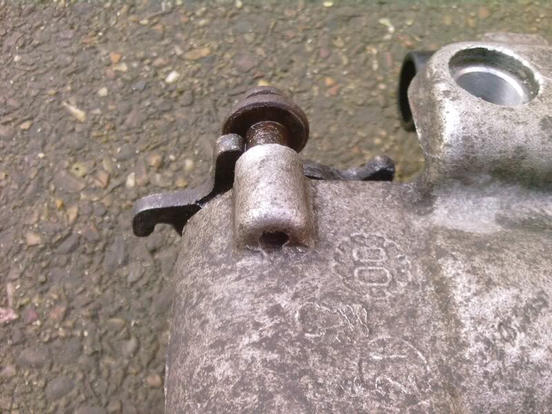

I've just came off the phone to Bigg Red (Very helpful by the way) who told me the stop post is just knocked in so it's just a case of knocking it out via the hole in the bottom of the lug where it lives, they said they normally come out ok but if its stubborn give it a bit of heat, so top marks to everyone who said it was pressed in :D
Best to know for sure though as the last thing I want is the lug on the caliper breaking off :(

You'll be best supporting the lug with a notched plate or something, rather than the whole caliper - that way there's minimal risk of fracturing it.

Thanks for that tip, I was thinking of what would be the best way to support the caliper housing while drifting the post out, as you say some sort of notched plate should do the job. :)
