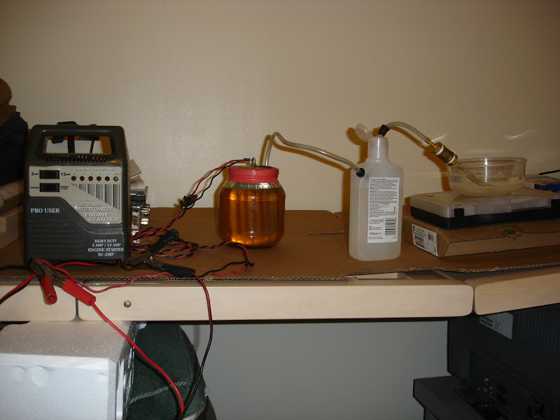

Well cheers guys for your helpfull input about this project of mine.
Anyway i have been spending some time on this and one or two explosions later i made this.
The jar has 4 stainless steel spatulas wired + N N - filled with tap water and half teaspoon of Baking soda. While leaving it running for well over an hour it only pulls about 2/3 amps.
So the gas goes through a bubbler then theres a safety flashback arrestor.

Not bad for a first try. A few things that I notice from your setup though. Firstly, the spacing between the plates are too wide, you want as close to 1mm as you can get without the plates touching, that way you need less electrolyte. Also, bicarbonate of soda turns the water brown, it basicly leaches the iron from the metal even though it's stainless, happens with 304 and 316 in my experience, I use sodium hydroxide. A little tip for you here, as the plates are all in the same bath of electrolyte the current will try to jump around your neutral plates instead of going through them, this will raise your amperage and heat and it will cause a runaway effectt that just gets worse the longer the unit is powered. Wrap an old bike innertube around the cell and it will raise the efficiency of the cell by a lot, you can then raise the elecrolyte concentration and get more gas for more or less the same current draw. Great job

Thanks marty1979 for your advice. At the moment the plates have a 2.5mm gap between them as there held together by 4 nylon bolts with the nuts separating them.
Yes your right about the water turning brown from bicarb soda. So you recommend sodium hydroxide.. I'll have to look out for some.
Not sure about the innertube idea though.. Do i wrap it around the jar or the plates themselves?? How would that have an effect?

The innertube isolates the edges of the plates, so instead of the electricity taking the path of least resistance, as it does, and bypassing your neutrals and heading straight for the other powered plate, it will have no choice but to pass throught the neutral plates between the anode and cathode which will infact turn the neutral plates into active plates, which will give you more gas
Insert the cell stack into the innertube just so the top and bottom is open to allow the water to be drawn in from the bottom and gas out the top, I hope that makes sense? As for where to inject the gas, I aways put a fitting as close to the inlet manifold as possible, always saw better gains this way, but it is a bit harder as this usually means hacking the intake pipe, maybe the airbox would be better as it's a lot easier to repair if you need to. Don't be tempted to use a vaccum pipe to suck the gas in, water boils at a lower temp when under vac and you will boil the cell, good old days

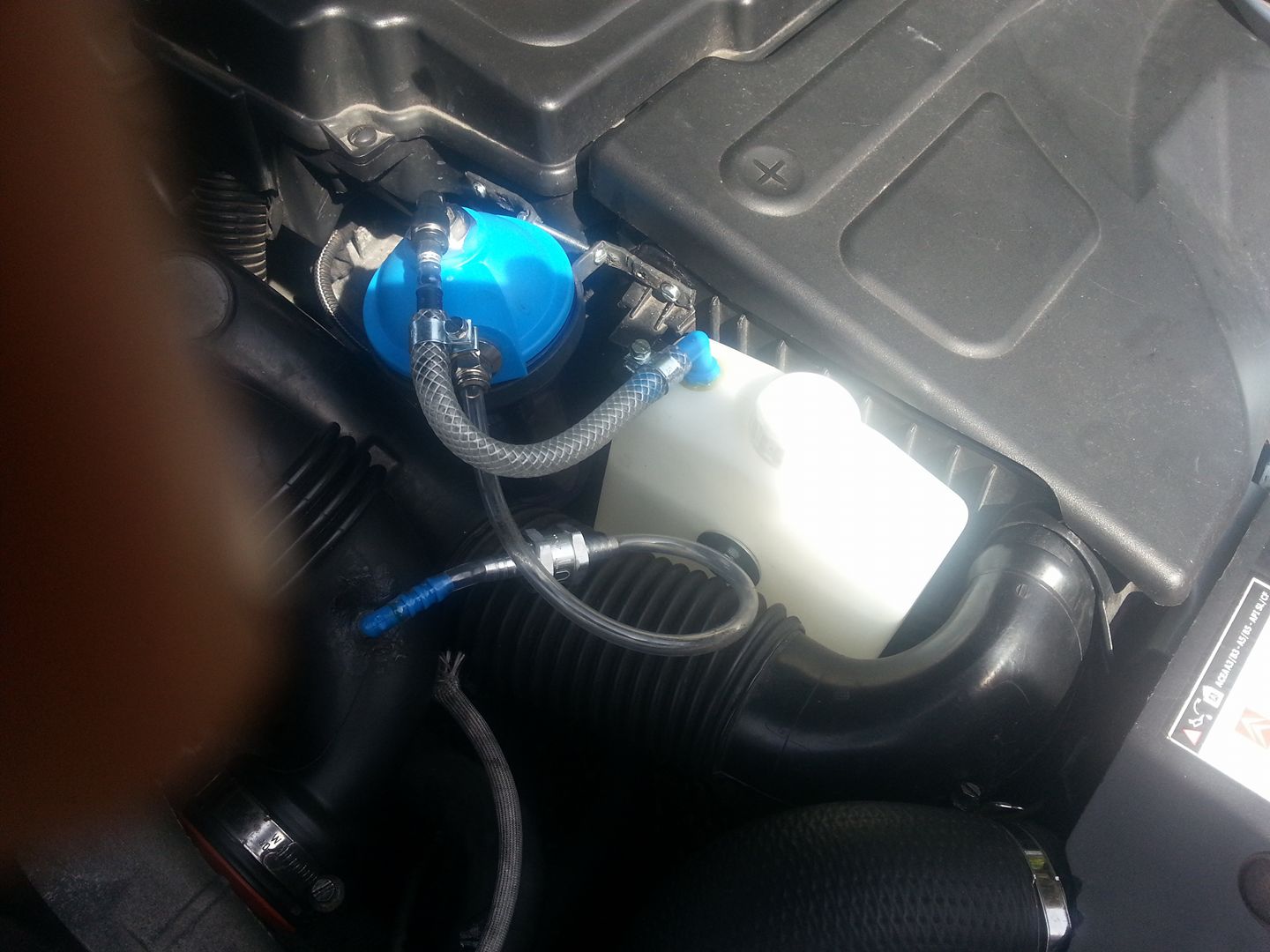

I have just fitted a Hydrogen Fuel Cell in my 2006 Citroen C5 1.6 HDI. It is a cell I made my self from 316 stainless steel it has 13 plates (1 positive, 2 negative and 10 nutral plates). The rest of the system consists of a 1.5 Litre header tank, a bubbler, 30amp fuse and relay the relay is switched through the ignition switch with a 7.5amp fuse inline.
The catalyst that should be used is Sodium Hydroxide in deironized water. The mix I am using is 2 level 5ml medicine spoons in 1 litre of water this means I am running it at about 9 amps.

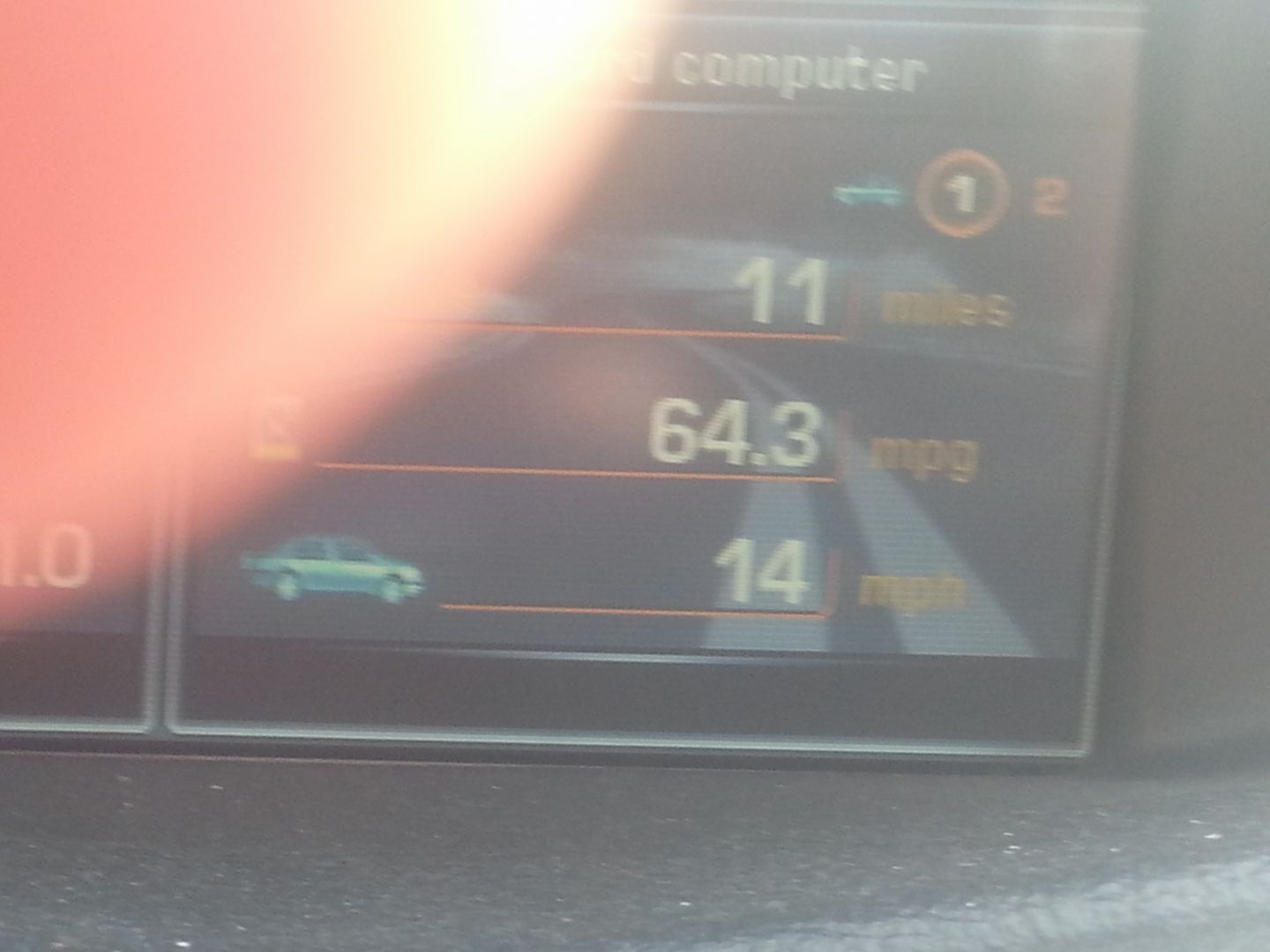

After installation I took the car for a test drive the car runs much smoother it pulls better and the fuel economy has almost doubled. The test drive was stop/start along Eastbourne Sea Front
