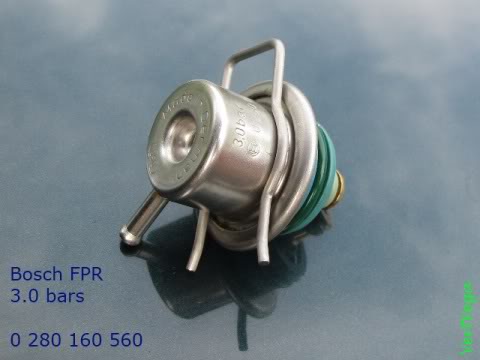

1.8 16V had the same injection system as mine and Bosch FPR with same product code numbers on it

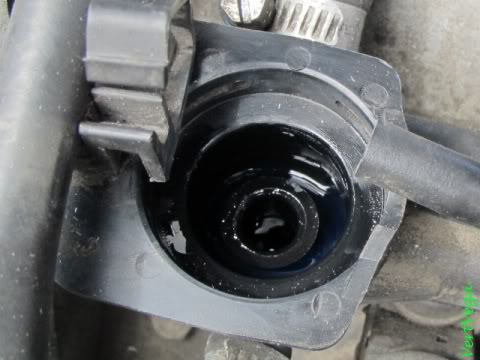

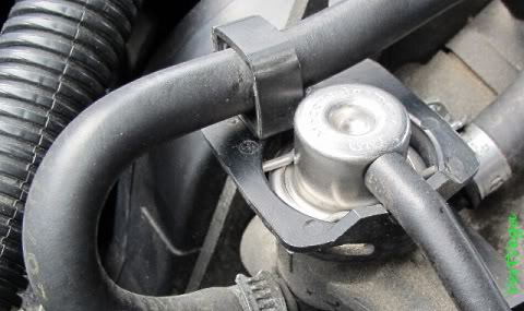

Donating car was a Xantia 1.8i 16V ´99 Automatic and FPR was still on top the engine.
I got the chance to "train" how to remove it.
It was easy but I was cautious not to brake it.
- Removed the retaining clip.
- Disconnected the tiny hose.
- Pulled out FPR (first gently lifting it up with the help of a screw driver).
On mine, I waited for the engine to cool down and I disconnected the battery terminal before starting the job.
Here are some pics and hope that they would help others (FCF members and guests).
FPR from scrap car (Dusts wiped and on the roof of my Xantia):
FPR removed:
Job done:
