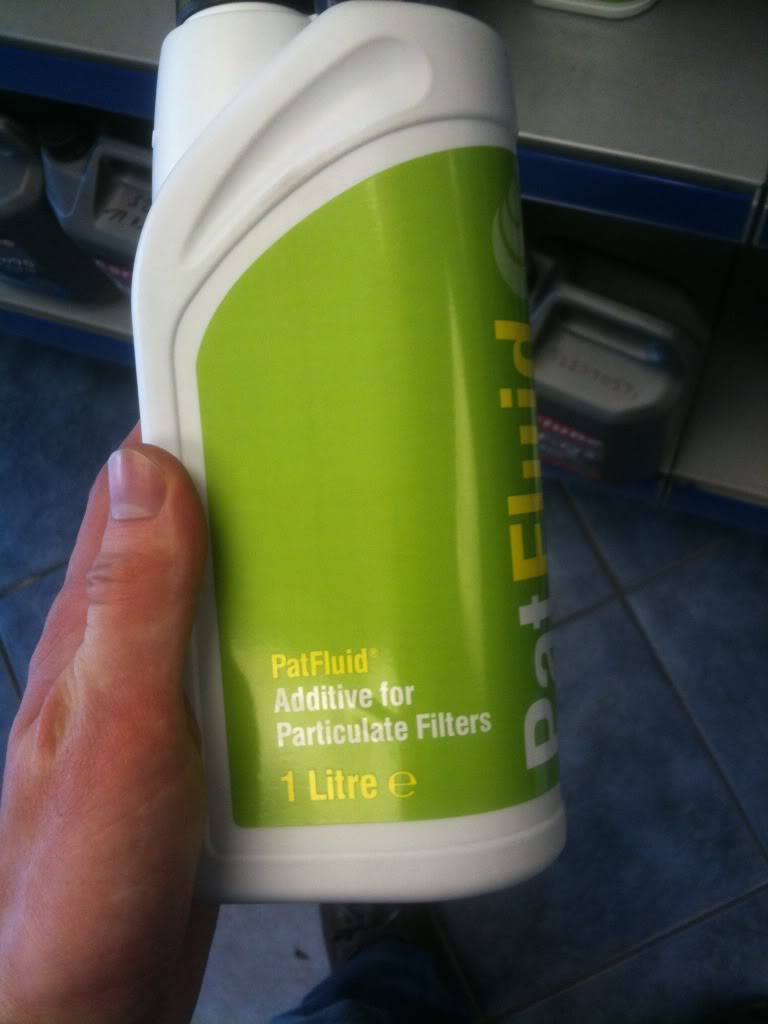

Has anyone spotted this before? Found it in EuroCarParts.
Priced it up on the web, £37.15 for one litre, £112.45 for 4.5 litres.
x 2941
It might be a good idea to check its suitability before using, I read somewhere that Citroen have two types and the later type must not be used in the earlier system. G.
See this:
4.2. Fuel additive ECU
New ECU maps permitting adaptation to the different types of additive :
DPX42 additive
EOLYS 176 additive
4.3. EOLYS 176 additive
New composition :
Cerine : 6,5 % by mass
Catalytic converter : brown colour
Solvent product (combustible hydrocarbon)
Additive tank :
Identification : green ring on the clickfit cap
Filling the additive tank (partial) : refer to the procedure given in the mechanical file of the vehicle in question
URGENT : It is forbidden to mix the 2 additives .

Need to check but in so much I recall that price is not markedly different to the Genuine article from GSF and the like.

Thought as much to be honest. It sparked my interest in the store because it didn't have a price next to it!
