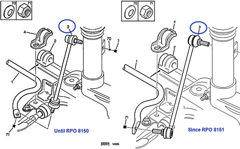

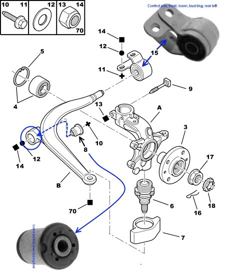

I hope this pic will help to identify the parts,
(Car breakers option?)
Anti roll bar drop link is either upside down "L" form or "Z" form depending on MK1 or MK2.
PS: Check PM
Edited: 11.7.2011 Edited above diagram by adding component pictures.

I know now that number 15 is one of them as for the drop link still not sure, car breakers is an option i'll give it a try.

Drop link pics. (Drop link is not a car breaker option :wink:)
My choice would be Lemförder (German) if you want them to serve for many years.

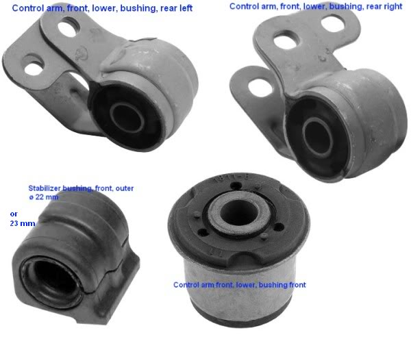

The other part is the anti roll bar bush,there are 2 sizes 22mm and 23mm wich one would fit in mk1 xant?

Ref wrote:The other part is the anti roll bar bush,there are 2 sizes 22mm and 23mm wich one would fit in mk1 xant?
Usually Estate models have the thicker option :roll: but not 100 % sure which one you need.
I have copied parts pics in one pic. As far as I understood you need the item
# 15 (upper two parts in below pic). Both right and left side?

the start of this thread you say "lower control arm bushes and sway bar lock"
the bush mentioned here is the suspension arm and almost cerytainly No. 15 in the drawing above, which we call the P bush,
not sure what they are calling the sway bar lock, but the usual part that fails is the dop link No. 3 in the first drawing,
here is price and part No. for a drop link and an anti roll bar (sway bar) bush which is to fit a 22mm sway bar,

Ok here are the parts that needed to be changed..
Nothing was wrong with the drop link!
It was done in 30 minutes :)
