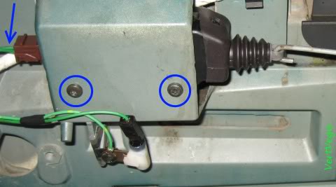

In mine it was the solenoid. I replaced it and since then no problemsJohn Plum wrote:... I understand that it may be due to the solonoid switch and/or a worn pivot arm coming from the same switch.. is that about right?...
I can add a link to the thread if I find it.
PS: Tail gate plastic membrane must be well sealed, otherwise you might have water flood issues
I found that thread (Oct.2009
So since 2009 no problems!
---> Taligate lock problem

Re: Xantia Estate boot not locking on autolock: Is it the...
I found a pic where the wire color is seen but it doesn't help much ...John Plum wrote:... which colour wire in the loom to tailgate serves the solenoid?...
There are several other thin green wires there
You need the 4 digit number code of the wires.
