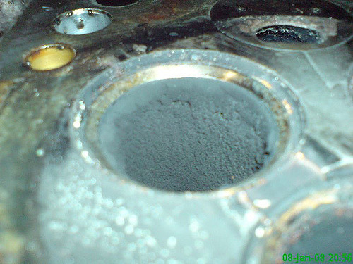

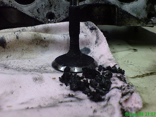

I think that on a diesel (fitted with EGR) it's a good idea to strip the induction system, clean the pipes, soak/clean the intercooler with diesel (red is ideal for this use being very cheap) and blank off or thoroughly clean the EGR. Blanking off the EGR on my C5 (2.0 110) wasn't really the right thing to do because it provides extra heating to warm the car faster on cold days. The amount of gunk that accumulates is significant and can't be good for efficiency.
Here's how the 2.5s inlet valve looked-
This car used no oil between changes but look at the carbon build up-
Steve.
