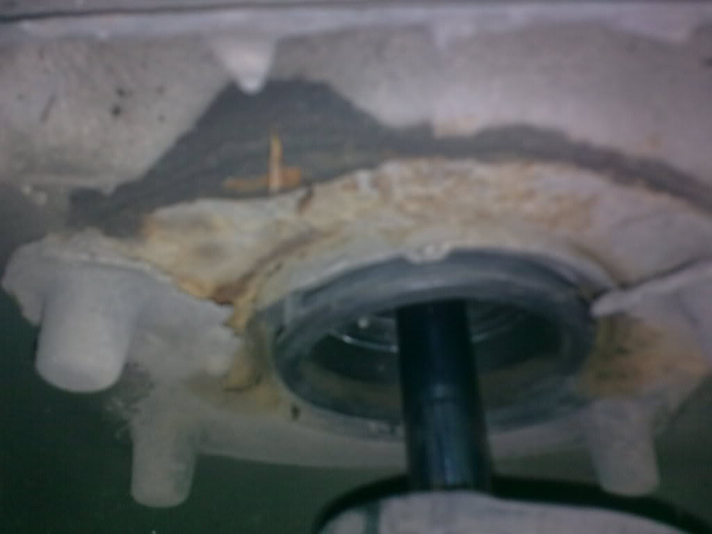

the engine has been removed from the activa.
there is some rust on the passenger strut top, which i will have to get sorted.

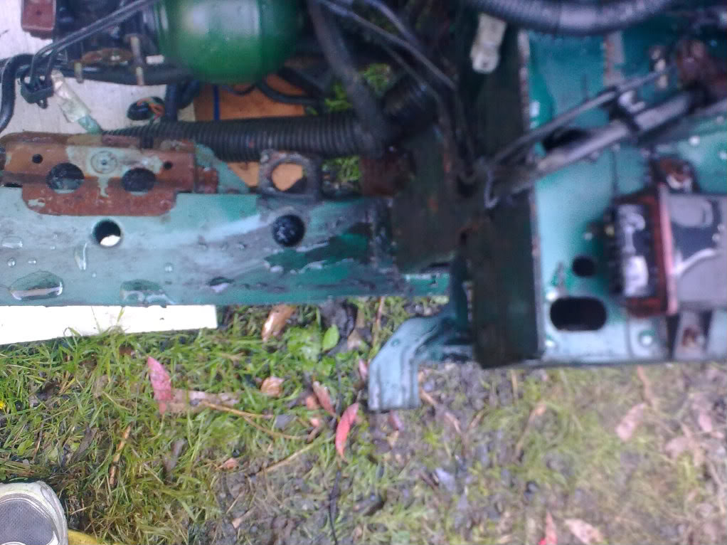

Unread post by davoxx »
RUST!!!
STRUT RUST!!! - need to sort out :(

I need to sort out that strut top. I really should have sorted it before I tried the conversion.

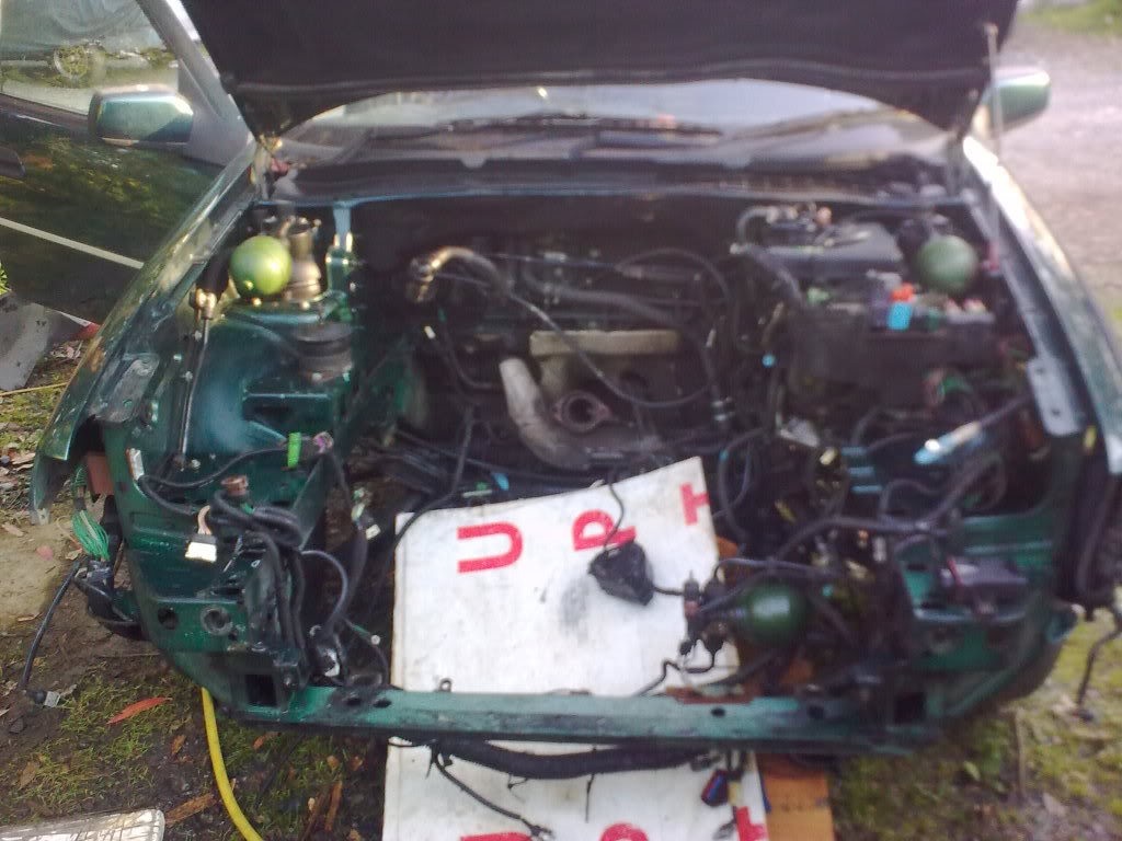

HDi engine is out now :)

now the fun starts - hdi into activa.
and it is a series 1 body that is getting a series 2 automatic wipers, aircon and what not!!

i'm terrible with following up ...
the engine is in ... it starts!!! so all signs point yes!!!
all it needs are a few minor bits and pieces, getting the rust sorted (again), and hopefully by next week i'll have the first RHD HDi 110 Activa!!!
