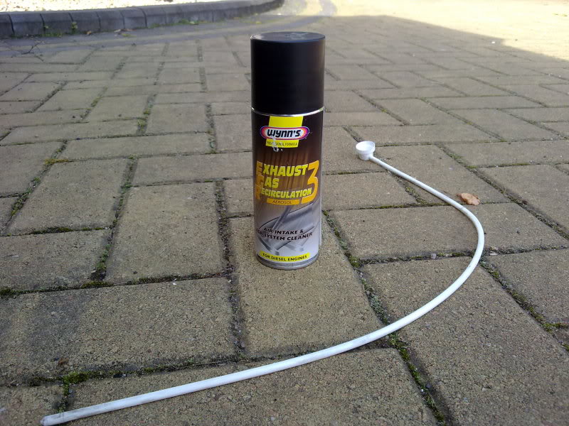

Well had a look at my EGR spray, it is indeed EGR3 but it came with a normal nozzle + a long reach nozzle. It is desinged to glean the EGR valve & inlet track with the engine running & still on the car.

I've been shortchanged again! I didn't get a long pipe with my two cans :-(

cachaciero wrote:I didn't get a long pipe with my two cans
Me neither. That extension looks really useful.

That long pipe looks like it would pretty well feed all the way down to the EGR valve. Just spraying in EGR3 into the inlet manifold as per the instructions none is ever going to get to the actual valve.
Actually I don't recall anything in the instructions about injecting directly onto the EGR valve or the gas duct from it to the manifold. It was for this reason that I thought Wheeler had a different product. That coupled with a belief that it would require two different products to remove the relatively soft carbon / oily sh*t that clogs up the inlet tract and the much harder baked on carbon that I would expect to find around the EGR valve itself.
