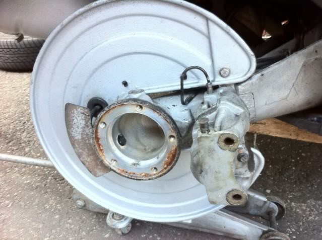

I've pinched one of SteelCity UK's photo's here - it is from an XM but the principle is the same - you can see the calliper sans retaining bolts but held together with the pad retaining bolt - here Steve has removed the calliper to get the disc and hub off.

Sorry to alarm you but judging by the condition of my rear calipers after I had inspected them during my C5 rear end job (see earlier posting) there is the possibility that the corrosion has eaten away the disc pad retaining bolt eyes !!! The results of this are not for the faint hearted. I have replaced calipers, bolts and pads and sealed the mating surfaces with anaerobic sealant - just as per Mr. Haynes. I do not expect to revisit the rear end again for another 50K.
Hope this helps : take the rear whhells off and have a close look - it is not hard to spot the problem you are experiencing.

Okay as said bump bump bump coming up to junction braking in wet.
Just got outta garage.
I need NEW REAR CALIPERS as they are corroded in the usually stupid way.
Plus PADS and DISKS.
Athat's on top of the new calipers and pad n disks on front wheels two or so months ago.
WHAT'S THE LIKELY DAMAGE FOR THAT?

The callipers do not need replacing on account of the corrosion, this can be removed although it is a bit of a job and most workshops just replace with new.boristhespie wrote:Okay as said bump bump bump coming up to junction braking in wet.
There could be other damage to them caused by them being distorted of course.
