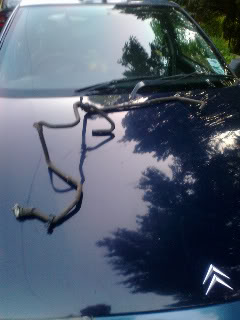

Whilst fixing a leak on my Bosch pump I knocked the plastic coolant hose (3 way) bleed screw. The plastic has sheered off from the union hose to the Fuel filter + the engine block.
Where could I get such a beast? Are these sold after market by GSF or Euro parts?

It'll be a dealer only part and it's not easy to replace as you'll find it's part of a long hose that snakes around a bit.
I'd be tempted to look at tuning bits, specifically turbo stuff, for a brass or heat resistant plastic tee-piece that will take all three pipes.
If you go down this road, you can still bleed effectively by loosening one of the pipes.

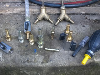

Mod idea:
First install one on these:
http://cgi.ebay.co.uk/6mm-1-4-BRASS-BAR ... 3a54fb497a
Then one of these inline:
http://cgi.ebay.co.uk/RENAULT-5-GT-TURB ... 5d2efd5f2c
What are your thoughts on the use of a fuel bleed valve for the coolant?
JG
JG

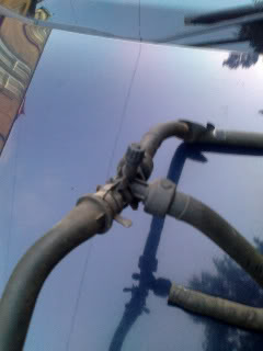

Cheers Jim,
Sorry if I am labouring the point here. I am paranoid about damaging the cylinder head with trapped air.
So this is the state I am in. The bleed valve connector has sheered the short pipe returning inlet under the fuel pump. It has sheered the pipe to the engine (right hand side).
I have removed short pipe from under fuel pump and this has drained approx 1/2 litre of coolant. I did this as it was too short to connect my 6mm brass T-piece too.
Jim, are you saying just simply connect up all three pipes to connector and add coolant to the expansion tank with cap off and engine running after having refilled it?
- Posts: 55216
- x 8458
Yes, that's it Jamie..magictorch wrote: Jim, are you saying just simply connect up all three pipes to connector and add coolant to the expansion tank with cap off and engine running after having refilled it?
Honestly, as long as the heater blows hot air, the rad is hot all over, the temperature gauge reads as expected and the fans cut in and out then believe me, you're bled
I understand your paranoia well but if you follow my procedure, you'll be fine and if you have only lost half a litre of the original coolant this will be insufficient to cause a major air lock. They only happen if the system is totally empty after say, a water pump swap. Then there is a danger of an air lock causing you to think the system is full after only putting about 2 litres in.
If filling from empty, fill up with all bleeders open and keep filling until they dribble and then squeeze the top hose a few times whilst brimming the expansion tank. When the engine warms and the thermostat opens it's likely you'll see a big air bubble appear in the tank and the level may rapidly fall. Stop and repeat the above.
It's vita to keep the tank brimmed at all times...
