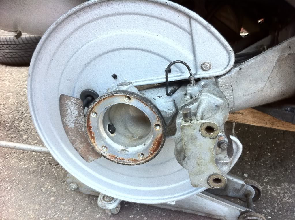

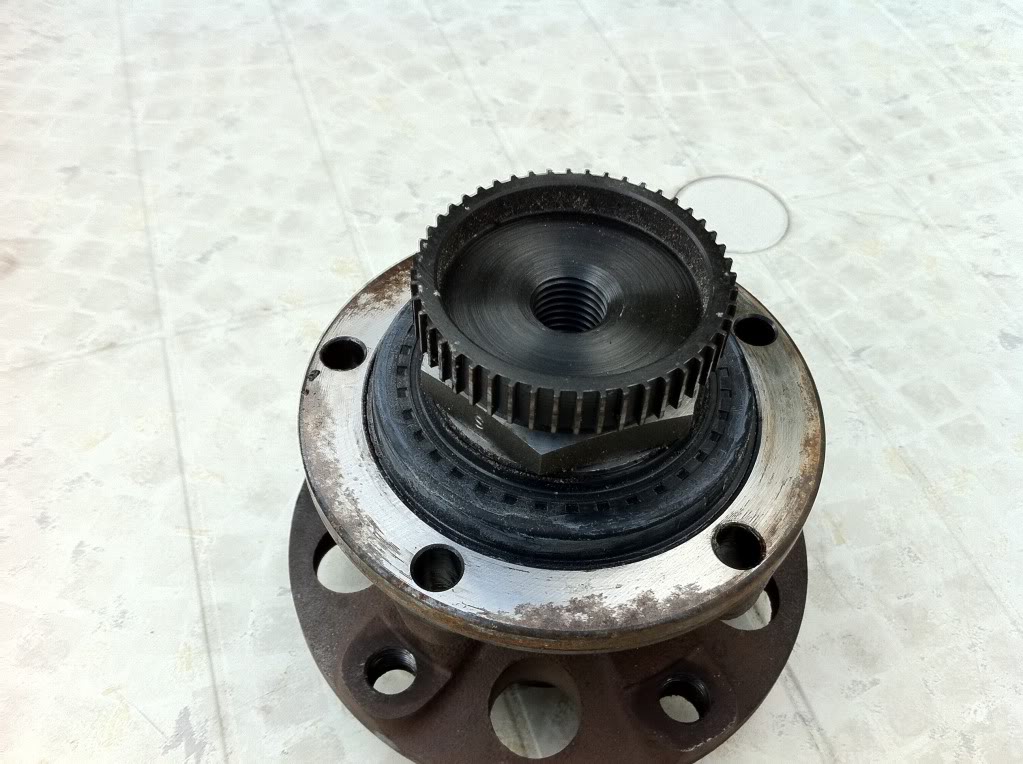

On Friday I bled the ABS block and the brakes again, I'm not sure if this has had much effect. Saturday I managed to read the fault codes from the ABS and Hydractive ECUs. Two permanent faults were logged for the rear ABS sensors - speed information inconsistent, that tallys with the behaviour of the car when stopping. Sunday was a good run into the Peak District, the car was comfy but the rear brakes are still releasing for a split second before coming back on again.
So tonight I decided to remove a rear hub and take a look thinking it would be full of grit or metal particles.
This is what I found-
Nothing obvious so I just cleaned everything up with brake cleaner, removed any corrosion and rebuilt. Next side tomorrow perhaps.
Steve.

Hi Steve,
Soon after I bought my 2.1TD in 2001 the ABS light came on and the selling dealer (Telfords Carlisle) 'fixed' it under warranty by replacing a rear sensor. However the fault quickly reappeared and on checking myself I found that the ABS loom running along the inside of a sill had been snapped and repaired in the past by simply twisting together the wire ends and applying tape ie a bodge. Soldering the broken connections and applying heat shrink insulation has given a durable repair with no further ABS lights, apart from those due to failed front sensors.
Ken
Ken
