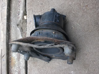

This is a strut top which i recently replaced. I will keep it in the shed just in case it can be economically recycled at some point.

XM's strut tops renovation is ordered from various countries and this project is moving fairly good.
Xantia's are moving very slowly as we don't get orders and renewed only a few for Lithuanian clients. But today we received a couple Xantia strut tops from France and will have some positive move.
For Xantia's right now and in the near future we will add (and weld) additional metal plate from the bottom if the plate will be hardly damaged by corrosion. In the further future we have plans producing new bottom plate, but currently we don't have such opportunity.
I've just covered Jim's personal info in scanned photos.
Regarding strut tops.
