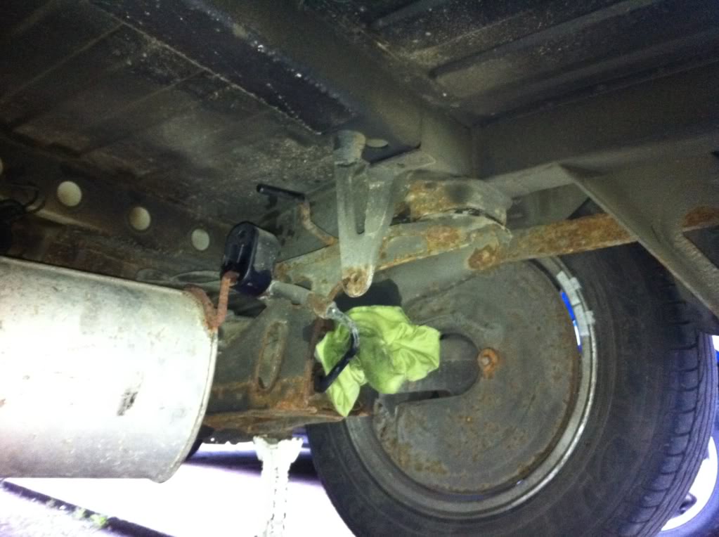

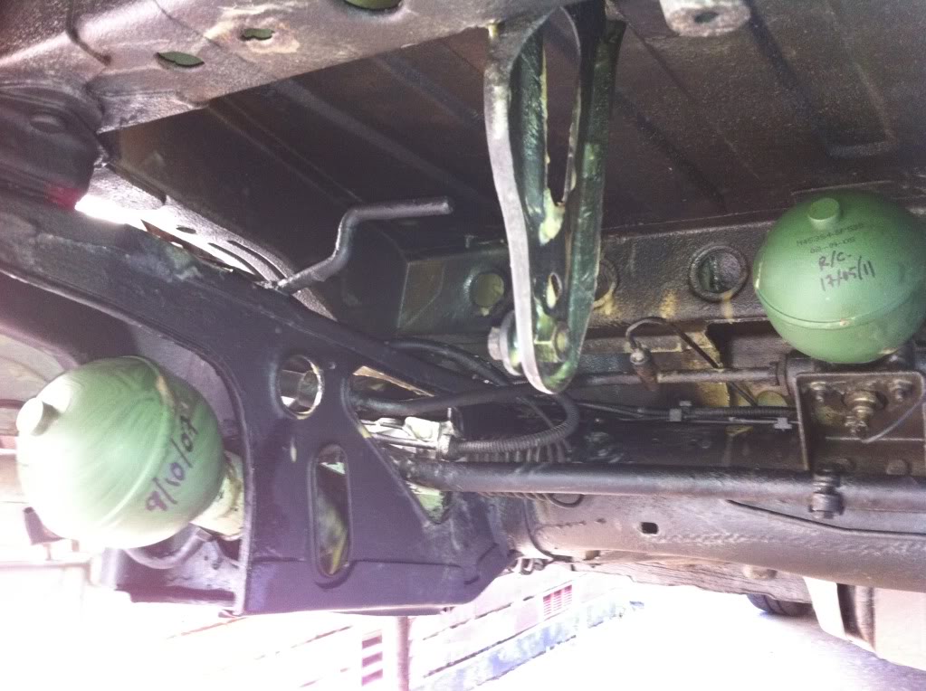

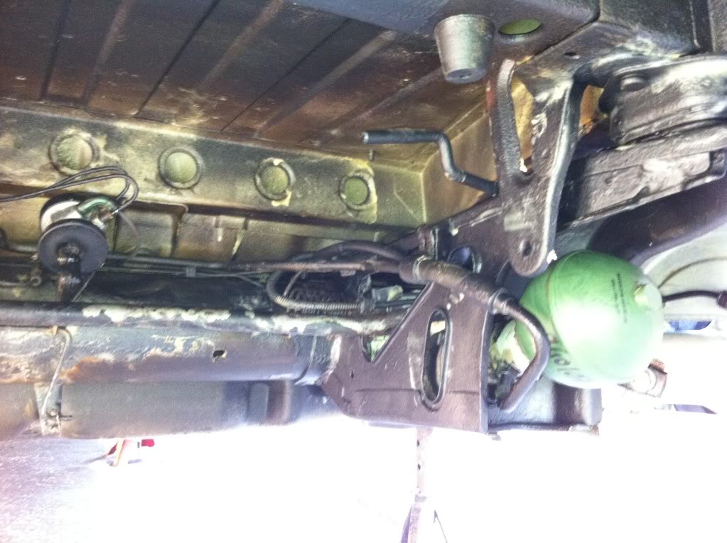

In a sudden outburst of enthusiasm I decided to investigate the rear underside of the XM which I hadn't seen. Hopefully it wouldn't be too rusty and I could check over the spare & cradle, change the Hydractive sphere, oil the H/C linkage and give it a coat of Waxoyl.
I took this photo because I thought it looked good on the ramps with the bonnet up.

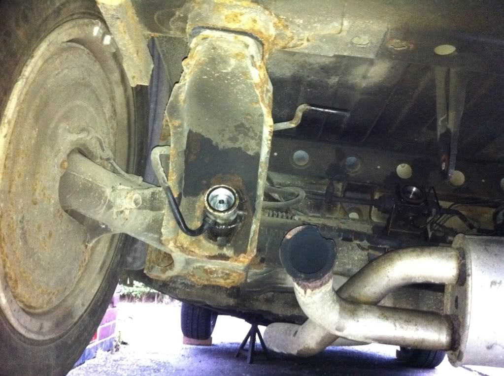

This is how it looked after removing the usual bits.

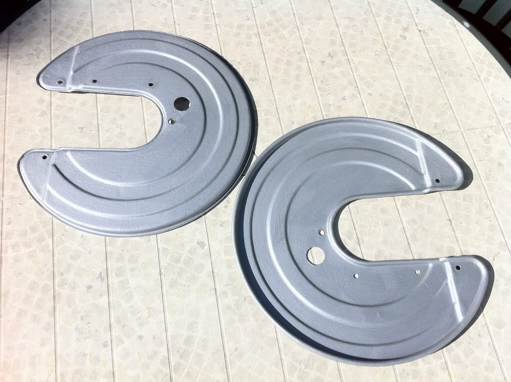

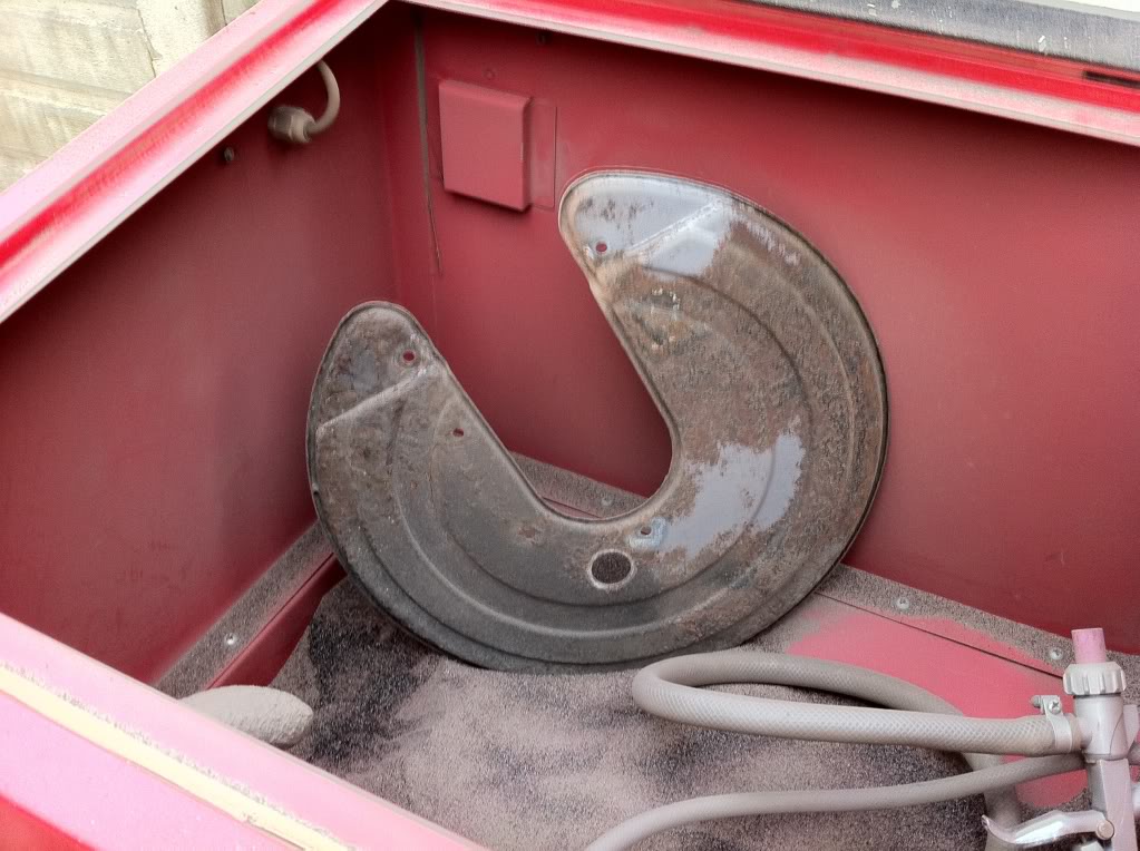

So with a Bank Holiday weekend ahead I decided to lavish a few hours on the old girl. The best I could think of was to strip off a few bits and grit blast them before giving them a couple of coats of Hammerite followed by a coat of Waxoyl.

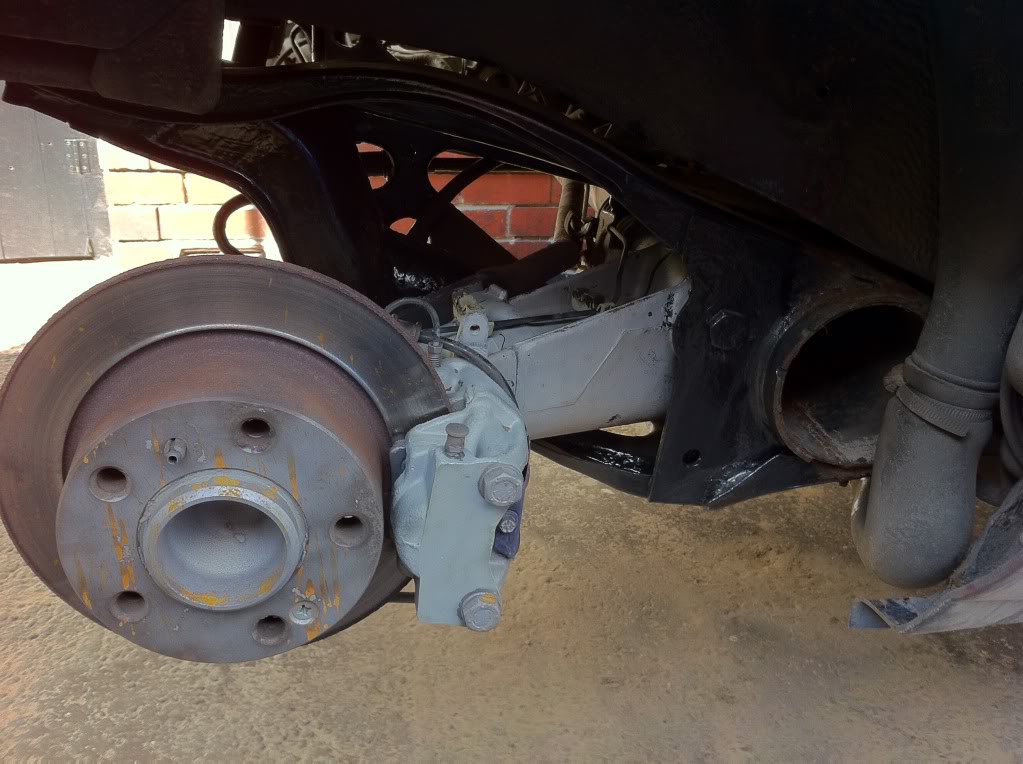

The rear disc shields have now had two coats of smooth Hammerite.

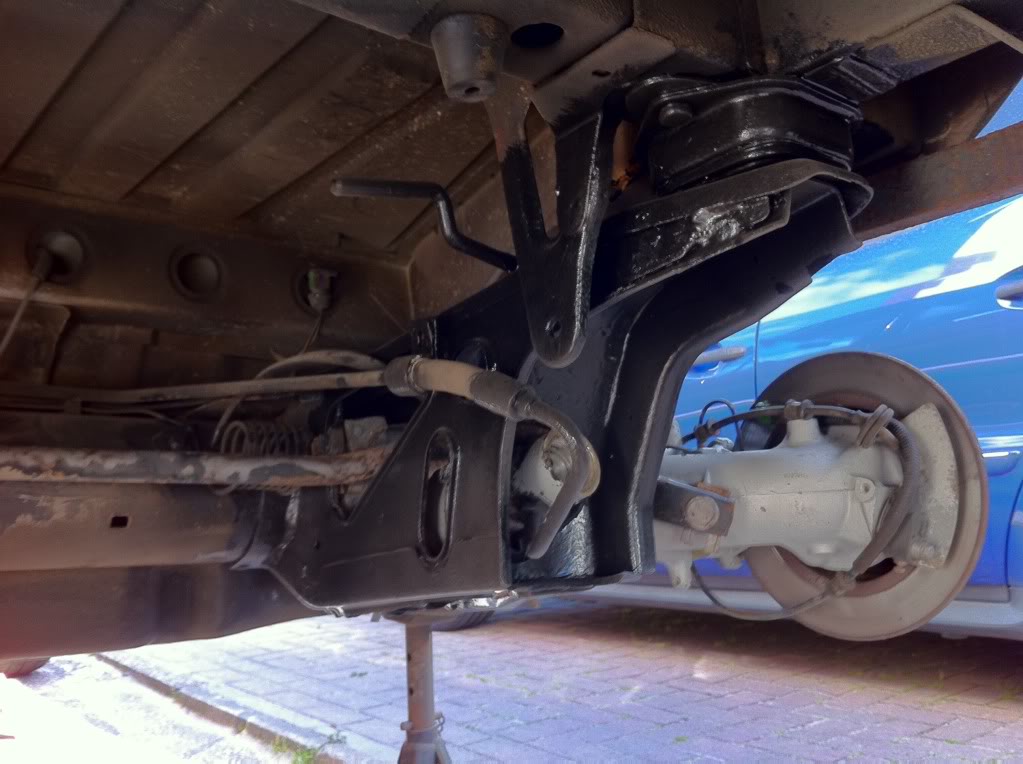

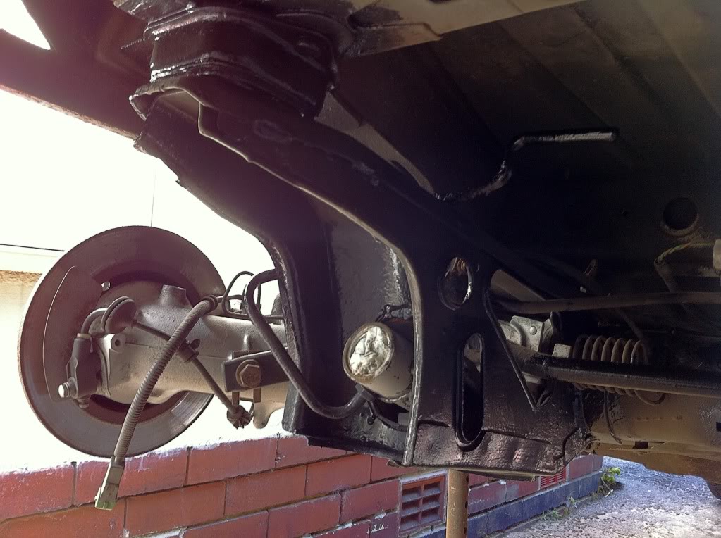

The rear subframe 'spurs' grit blasted and given two thick coats of smooth Hammerite.
The trailing arms and calipers came up a treat too. These will be lacquered to help keep them clean.

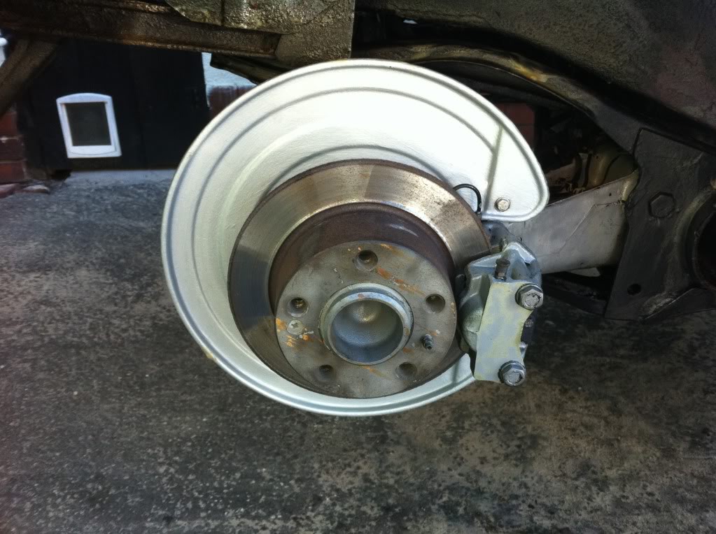

Disc shield back in place, existing bolts/washers replaced with stainless. When I've bled the rear brakes I'll put a smear of copper grease around the bleed nipple, brake pipe and nut.

These still aren't very good photo but then I'm not used to sunshine!
After seeing the finished effect the disc shields need painting black on the caliper side, at the time of painting them I was undecided but having seen them in situ it's obvious silver was a mistake.
