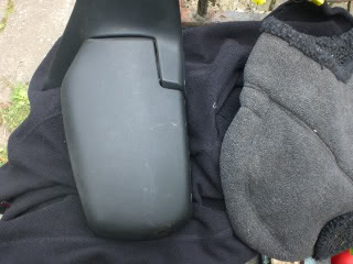

I have a wing mirror (electric) from a 1994 Xantia 1.9TD SX
I will post up a picture once the battery on my camera has charged up.
I also took some pictures of the process of taking it off which may help you.
It is the driver's door mirror I have, and its just the normal grey plastic.
Not sure if it is/was heated. It has two electrical connectors attached one white with two wires (yellow/green plus red), and one yellow with three wires (white,brown, and black).
If you want it let me know

I have a feeling they are going to be a bit too grey for you. Its the hot Northumberland sun beating down which bleaches them
As a bit of illustration the fleece is pretty black, my ear flap hat is definitely grey and the wing mirror is I would say....grey.
What do you think?
here is the url for a bigger resolution image
wing mirror, hat and fleece
