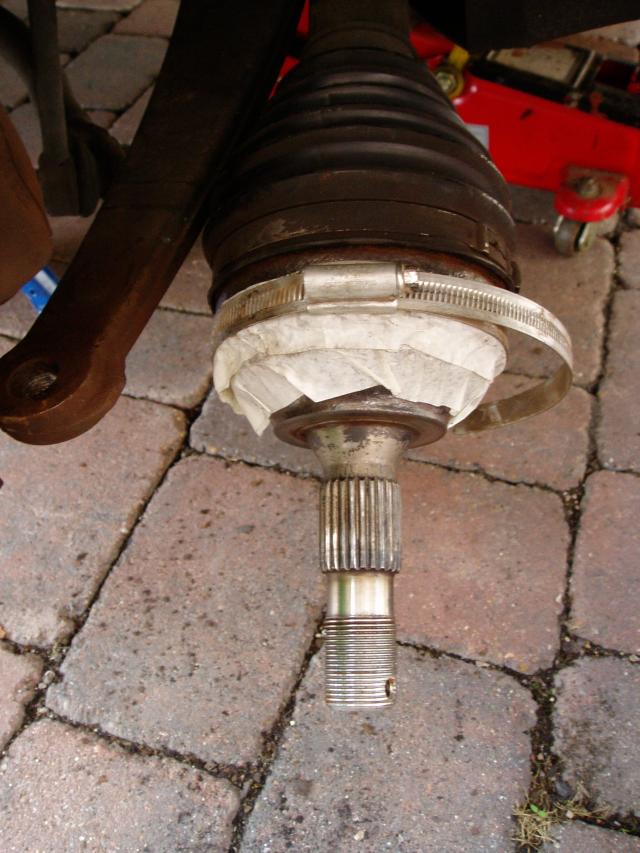

Here's how to Araldite on the ring...
Here's a picture of the ring setting under the Jubilee clip...The toothed ring on the offending hub had split. This in itself was not catastrophic, as the gap was tiny, but as it's only held in place by an interference fit on the driveshaft, it was able to gradually move sideways, away from the sensor, reducing signal strength.
Citroën do not sell the toothed ring separately, but as ever, the aftermarket is happy to fill the gap. A Google search on "ABS ring" or "reluctor" will quickly turn up several sources. UK Parts Direct is one source and they cost around £17.
The website indicates all Xantias use the same part but that is not so. Check the dimensions of the old ring very carefully.
Thoroughly de-rust the ring and the hub and then araldite it in place, using a large jubilee clip to maintain tension and position until
the glue cured. A couple of coats of paint on the top & it's been fine for the last 6 months.
Note use of masking tape between the jubilee clip and the toothed ring. This will prevent the clip becoming forever stuck to the driveshaft........
The "official" technique is to heat the replacement ring to dull red and then tap it into place.
