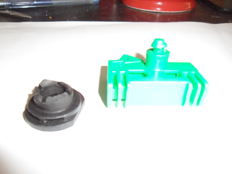

i have found a replacemnt regulator and ordered but in the glass there is a rubber grommet that the clip goes through which has become hard and brittle. do any of you know the name for this part and where i can order it? the company on ebay that i got the regulator dont seem to supply them and googles been no help

Not sure how much electric window fittings change from a 1994 1.9td Xantia to a 2001 Xantia 1.8i Petrol, but I do have doors and windows from my 1994 car which I would be happy, if i can, to extract any parts you need which may be compatible.
If you could put up a picture of the bit you need it would be helpful.

That's it - difficult to tell from the pic on the parts diagram, but it may well contain both. It's shown as a bit that looks similar to the rubber plug, interspersed between the regulator and the window. I'll try and post the pic from service.citroen later - their descriptions are not always intuitive

I have a packet of the rubber gromets in the garage, send me a pm and I'll post you a couple.

thanks again kenny. parts turned up and although it was hard work and took me nearly 2hrs the window is fixed. hardest part was getting the glass in the correct position as it kept popping back out. still my first repair and i have saved a fortune on garage costs. couldnt have done it with out the help from this forum so thanks every one. now how hard is it to change front discs and pads
