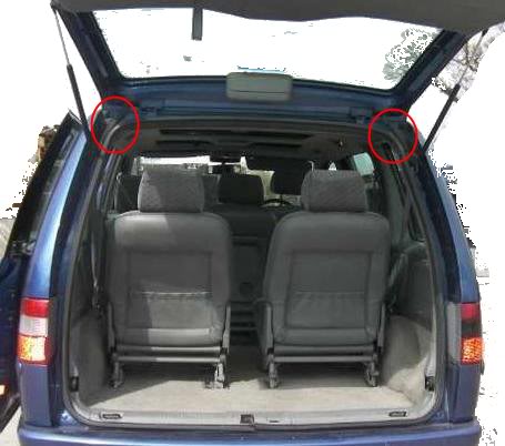

Looking at the Synergie tailgate (which is like an Estate tailgate :roll: ), I would also suggest that
wires in the outlet(s) might have shields damaged and two wires are in contact with each other.
Rear lights and side lights might be both energized when either of them is turned on.
Edit: Marked in pic below
