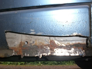

Heres the preparation so far for my welding job. The original cill was spot welded along its length at the bottom.
Look like I have used a banana to mark out the top edge-I will have to straighten that out :) .

thats fine as it is and just needs a piece cut to fit, very easy job,
regards malcolm

Unread post by lexi »
Look at the rust in there even with hot sprayed zinc coating :shock:
They will all be like that inside lest they have been waxed.
It is the crimp at the bottom of sill that forms a double skin.........always deadly as a moisture trap.
