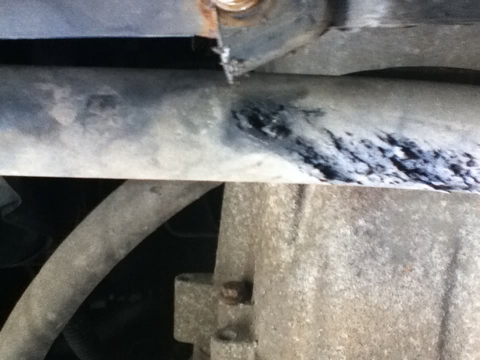

Things just get better. Tying everything up (I've the central plug fixing missing on the passenger side wheel liner), I find the undertray has cut through a padded pipe on the driverside in front of the wheel and along the edge of the remaining trim.
What is this? There seems to be oil coming out.
Here's a photo
Here's a photo

You can't blame the under tray falling off a car to be a fault of its own. Its either been put on wrong or its been caught on a curb or something similar. The undertray should not touch that pipe either, certainly not cut into it, so I suspect incorrect fitting which has also made it fall off.
With Steves (myglaren) experience of his wheel arch trim disintergrating due to the lack of an under tray at one point, I dont risk driving without it fitted. Not for high speeds anyway.
