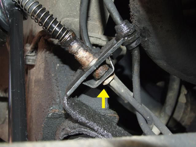

Hey folks, just to confirm, is this the nut I want to be undoing when removing the front flexi-hoses???

Yep, that's to release one end.

Cool, thanks... just wanted to double check as tried the offside hose and it put up a hell of a fight.... just found the handy hint about crushing the spring clip, so off to try that now... Many thanks!!! :D

dont crush the spring clip unless you have a new one to re/fit in place, as that is all that secures the hole lot in position after re/fitting,
i have never had to crush the spring retaining plate,
regards malcolm

oh.......
oooooops! I followed the guide and gave it a squeeze.......
I have got the facilities to reshape it once it's off though....
What I dont have is a removed flexi hose..... It's stuck pretty hard..... My Flare nut spanner is really starting to slip on the thing..... I think it was a little chewed to start with...
I might have one last option. I have a user friendly sized set of stilsons??? I know it will be messy, but I don't think I have any other choice....
Unless anyone has any other suggestions??? :oops:

A damned good going over with a decent wirebrush and using the correct
penterating fluid - Plusgas spray (NOT WD40!) which, should do it but if
it's still putting up a fight it's then followed by careful localised heat from
one of those pencil flame jobbies ONLY on the side below the bracket of
the wheelarch - there aren't any seals in this joint but obviously the hose
won't like getting a flame on it!! You really don't want to destroy the nut
as that's going to remain on the car not get replaced.
Is your open jaw 11mm a decent tight fit on the nut too?

Hey buddy, it's a reasonable fit, much better than an open ender, but it has chamfered edges, so I am only gripping about 75% of the available area..... I don't use wd-40, I have been using zx-54 (the miltary stuff) and have been soaking the union since yesterday afternoon (have been out so drown the stuff I had to change today 3 times last night and twice this morning.. the street ice rink slippy!!!! ha...)
One thing I dont have is heat :( and as I am fitting new flexi-hoses I would kinda hope the new ones would out live the car, hence why I was prepared to get busy with the stilsons....
***edit--- just called local motor factors and they have plus gas in stock and are open till 5... off to the shop I go..... Another nights soaking is in order I guess......******

what i've had to do before as a LAST resort is mole grips set to quite a tight setting and just use them to crack the nut off. be very careful though not to damage the nut as its easy done. after you've got it to turn even 1/8th of a turn normal spanners should suffice

The nut will be very tight on the end of the flexi and even beyond most flare nut spanners. There is a serious risk of rounding the hexagon and then you can be in a whole world of pain.
I've had to resort to a pair of Bahco 8224 pliers in the past and these are just the job as they can grip the nut in their serrated jaws without any damage and apply plenty of good torque to the job. They perform much better than Mole Grips in this role... For me at any rate...
I'd not be without my Bahco pliers. They have saved the day on may diverse occasions, worth every penny of their cost... :D
