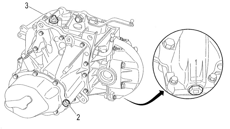

hi all can any body help me out i had to change the drive shaft on my c4 lost the gear box oil what i need to no is were you fill it up to cant see were the filler is to put oil in or to emty the gear box do any one no hope some one can help me out thanks for any imfo

cheers kev thanks very much and thank you for the photo of the gear box very good thanks a lot for helping me out cheers m8

here's some more info:-
5. Oil capacity
Empty gearbox : 1,9 litre .
After draining : 1,8 litre .
N.B. : The gearbox is lubricated for life visually check the sealing at each service visit .
URGENT : It is necessary to drain the gearbox and put back the exact quantity of oil, in the event of an external leak or a repair .
6. Refilling
Refit the drain plug (1) : tighten to 3,5 m.daN .
CAUTION : The filler plug (2) is discontinued from RPO 9975 . refilling with oil is via the air vent (3) .
Remove the air filter housing .
Remove the air vent orifice (3) .
Refill the gearbox via the air vent "3", using tool [1] .
URGENT : Apply the exact quantity of oil according to the engine version .
Refit the air vent orifice (3) tighten to 1,5 m.daN .
So, If your C4 is newer than RPO number 9975 then it has to be refilled via the air vent 3.
Tool (1) referred to above is like a funnel feeding a thin tube.
