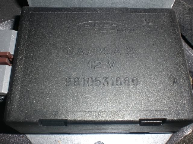

Hi all this is my first post on here, My partner and I are both huge Citroen fans, she has a 2CV. I recently went for a 1995 1.9 TD Xantia mainy due to the price of petrol.
Anyway the car is amazing however the D/S lecky window wont work I have narrowed the problem down to the black solenoid or switcher box. (the motor worked when I sent power direct to it)
I cant find a replacement anywere, (the Serial No on the box is CA/PSA 3 12V) any advise on the best and if possible cheap place to get one would be much appreciated.
Its getting hotter and I cant do without a window.
Cheers.
Liam
Cheers.
Liam

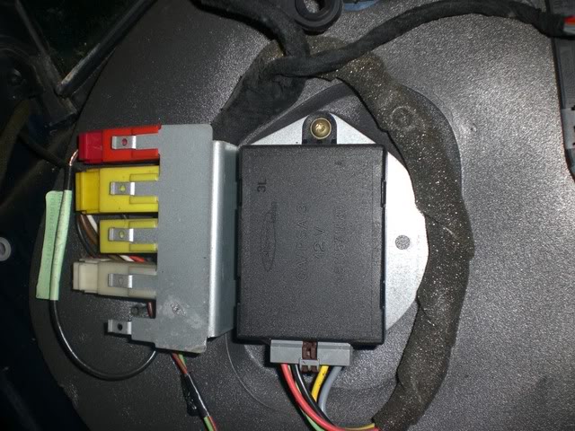

hi all. Thanks for you responses.
I am fairly certain it is the transistor box. When I first opened up the door trim the wires leading from the door handle switch to this box were disconected, I assume the previous owner had pulled this out as there was some damage around all the star bolts where he had ripped the door trim of.
My first step was to plug this back in, with the plug placed in correctly the window would go down but not back up again. when I put power directly in to the plug that was connected to this transistor box the window would go up or down depending on the direction of power flow.
There are only two wires running from this transistor box to the motor so I am assuming that these are sound.
I would up load images of the box in question if I could work out how to!.
Thanks again.
Thanks again.

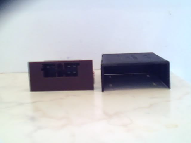

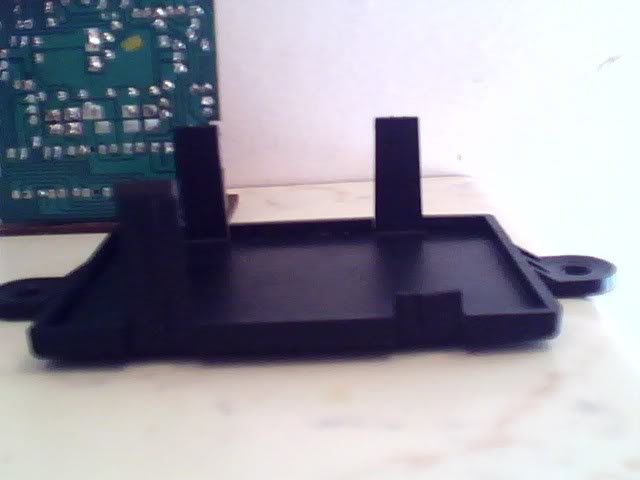

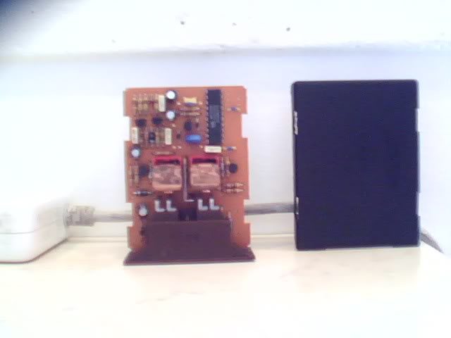

Thanks for the offer Neil that would be great. There getting old these cars now and none of my local scrap yards keep any of the parts.

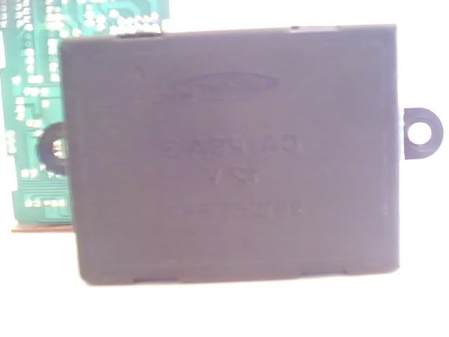

The transistor box I am after is to be found screwed directly onto the inside or the driver side door above and a bit to the left of the speaker set into the door. its black and about 2.5" x 4" X 1" the one I have has a logo saying Bitron Video on it with a serial number CA/PSA 12. If you pop the 4 clips of it you reveal a very 1980's curcuit board.
If you have an email or can explain how to upload pics onto the forum i have some images.
thanks again.
thanks again.

Just want to say a big thanks to Neil who sent me the box I needed. It is now fitted and all working. And the best bit is he sent it for free. Much appreciated.
Also thanks paul.. I was wondering why the new switch work differently... They run in reverse. Ie down is up and Vice a Versa and it is indeed one touch all the way down or up and one touch to stop rather than the up and down on my other window.
