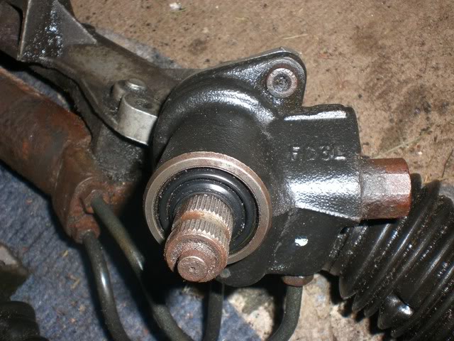

Steering rack 1 with mot "leak"

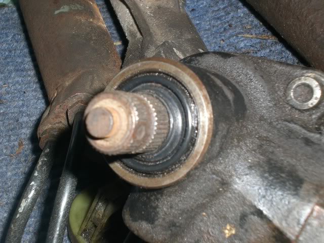

Steering rack 2 from now departed spares xantia
I can't see anything noticably different about the top seals of these racks. Both racks work well turned with mole grips on the pinion.
Nothing is under pressure of course but I am beginning to think that the original "leak" was not from the pinion. The seal is not hard and looks intact as far as I can see. The return pipe union did undo very easily and I undid it by hand after the initial very easy turn of the wrench-maybe this was the source of the leak.
I think my safest bet bearing in mind that rack replacement and removal is such a pain, is probably to install rack 2 from my 135,000 mile car wich had passed its MOT only a couple of weeks before the winter clutch job SORN-ed it for 5 years.

Hi Neil,
If I recall correctly I managed to fit the rack back into place with the
heat shield on and still managed to get the unions reconnected without
much big hassles. Have you fished out the pair of big round washers that
the rack sits on too as they're easily missed. A dab of grease will also have
more chance of holding in the square captive nuts for the big pair of
fastening bolts.
I found the top pinion leaked on mine and wasn't going to chance fannying
about with replacement seals so just swapped the lot for a known good one.
The feel of the steering is so fundamental to how the whole car works for
you that this really would spoil the car for me if there was any coarseness
in a replacement so you're right to use a known good one; I don't believe
the miles will be a big issue. Now's your opportunity of course to very
carefully check out the nearside rack gaitor to see if it needs renewal as
it is certainly a real git to renew in place. I'd even contemplate having a
pro old-school garage renew them if you don't fancy the spiggot removal
yourself.
The only other thing I recall on mine was the coloured nylon collar being a
bit fiddly to get into place when offering up the swivel clamp off the column.
Fingers crossed for dry warm weather for you and us all!!

Even though its a bit rustier, I think I will put on the rack I removed from the spares car. The "arms" of this rack support themselves much better than the arms on the other one. These fairly noticably flop which may indicate the inner ball joints on the arms are not as good as they should be. Gaitors both sides are intact.

Hi Neil,
I agree with Andmcit just change the complete rack, the steering pinion is a real pain to DIY as I found out myself.
Even if the steering pinion top seal doesn't look bad, if the other seals within the S.P. are gone, it will cuase the SP to be out of alignment hence the leak.
One you have done this once it does get easier to do again as you know the pitfalls :wink:
I can't add anything else to Andmcit's reply.
