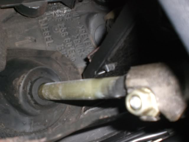

The steering colum in the car has to come off the lower UJ rod, then you can take the lower UJ off the pinion... 6x 6mm allen bolt holds that on... accessable through the wheel arch..
How much does the steering column inside the vehicle have to be dismantled to achieve this? Is it just the nut shown here, or do I have to do a fuller dismantling? The car does have an airbag-is this going to come into play if the fuller dismantling is required?
thanks Neil

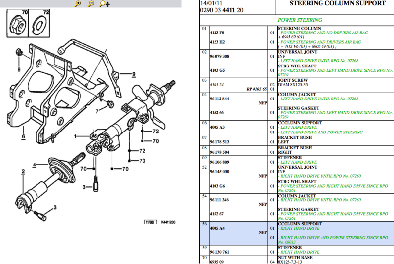

Leave the column all connected together inside the car and undo the joint
at point 2/3 in this piccy:
You can draw the column into the cabin clearing the rack.
Refitting is a fiddle that'll require an assistant!

I think my picture of the nut is the one at point 2/3 in the diagram.
Haynes does carry a page of dire warnings when working in the vicinity of the airbag, but looks like its not going to be disturbed this time.
