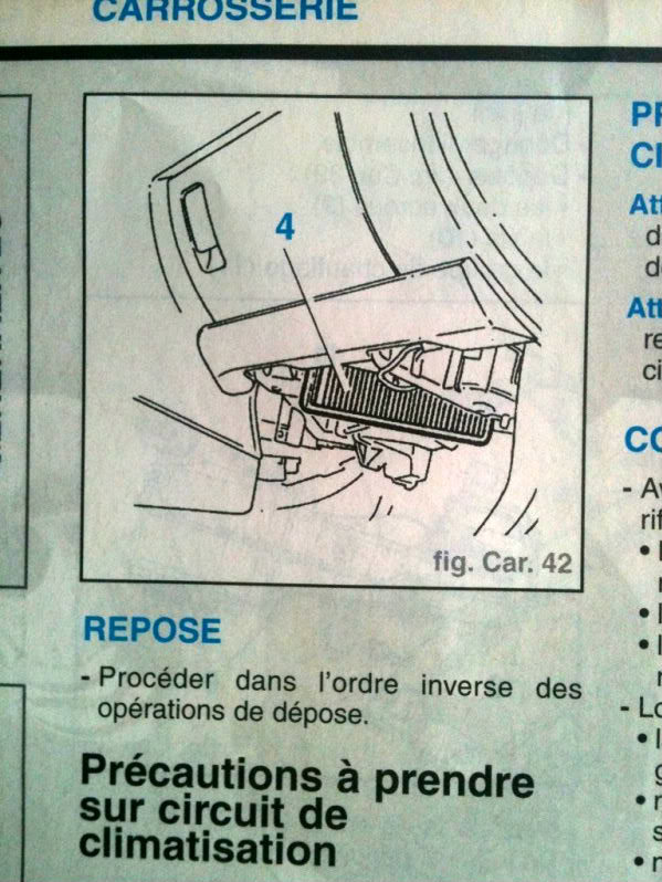

Read all sorts of things on the site around this issue, but can't find the answer,.. the air in the car is not fresh, ( yes I have a busted heater matrix, it's been disconnected 8 years ) where is the aircon / in car air intake , filter / pollen filter on a V6?

i think it,s below the glovebox behind the carpet trim

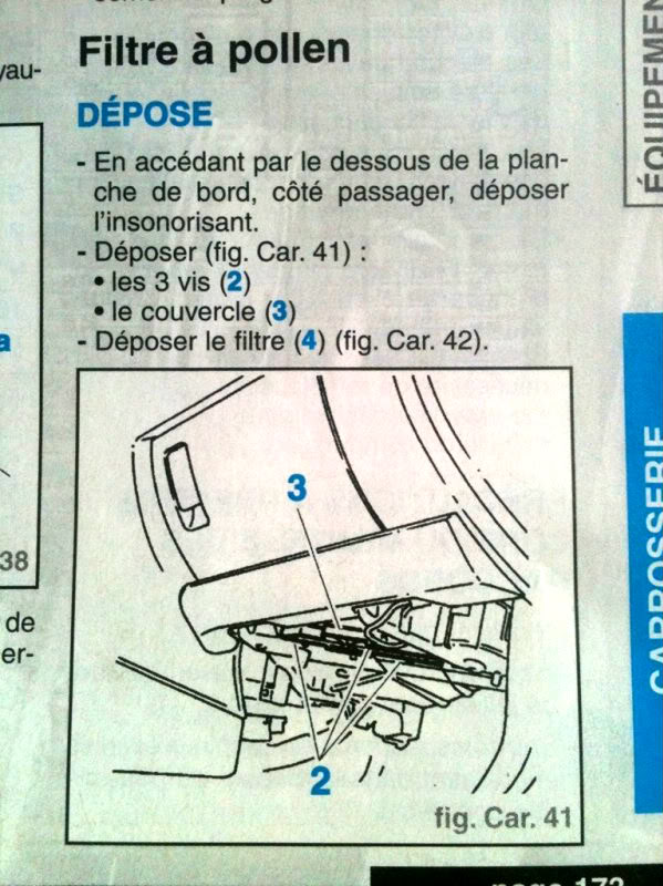

Filter with sliding cover to remove at bottom right.

Make a note of which way round it is (the slanted pointy end) so you don't have to stick your head under to look.

Also, it slides sideways to release, don't lever it off!

Beware!! Some have covers secured with four screws... I cannot recall id these are very early aircon cars or very late ones.. Fooled me the first time I saw it...

Jim, it was only on the earlier ones, later units were graced with one screw and the last lot did away with the screw completely. Not sure if this was an accounting measure to reduce costs or part of the fuel economy drive to reduce overall weight. :shock: :D

thanks all, job DONE
Did the VSX too, Jim, screws on the VSX but no screws on the V6.
