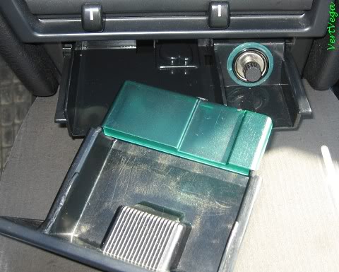

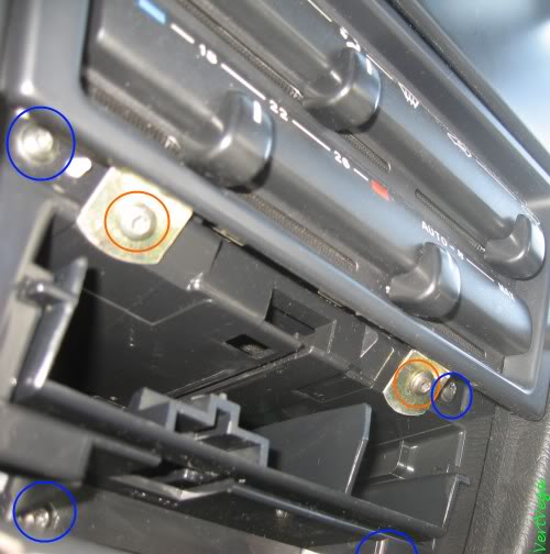

Taken some pics today. First the tray part must be removed.
There were more screws than I remembered :?
- 2 screws (orange circle) holds the frame and must also be removed
- 4 screws (blue circle) for the ashtray "sledge"
Lighter cylinder definitely comes from this side as seen in pic. but first
pull the sledge out and disconnect the wires behind. From this point on
you'll have the lighter removal and this part part was easy.
