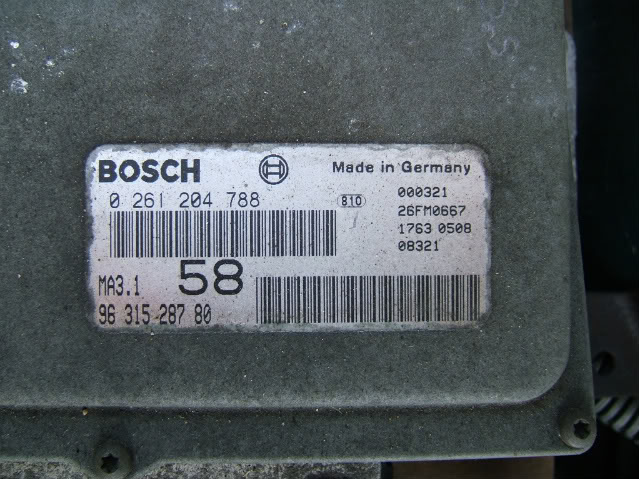

The inlet manifold is cast alloy, but if I had to guess then I'd say that it has single point injection looking at it. I don't know what the MAP sensor is?
Here a snap of the engine bay and one of the label on the top of the ECU
Rob

Thats a single point one there.
