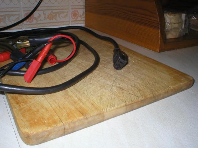

Malcolm, I can save you a job..
Here's the lead to run a Lexia from a 12v battery...
It's a strange plug and in all my time as a electronics engineer I've never seen one like it...
Running from mains needs the special power supply contained in the Lexia trolley. Again, it's a strange plug of the sort I've not seen before either...
One potential solution is to disassemble the Lexia (not an easy job by any means) and fit an alternative 12V power plug...
