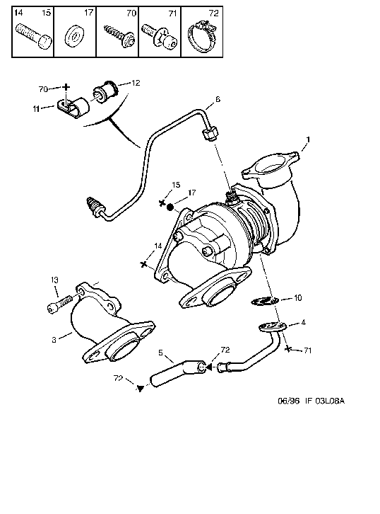

Does it actually have a gasket fitted there ?
Remind me which vehicle the engine came out of (and rough year) and I'll try to drag up a pic of the items concerned ;)
Some do not just have a flat fitting.
Andy.

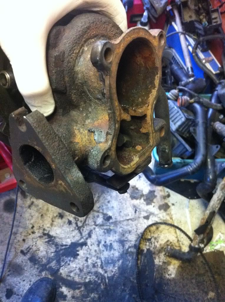

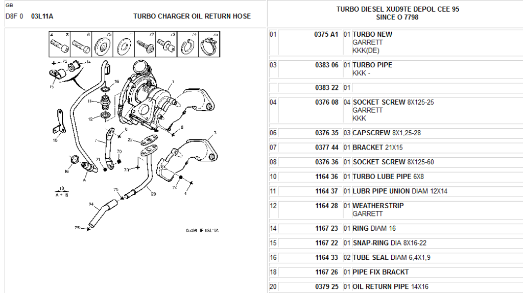

I recall mine (205) did not have any although I am going back a few years. Just checked all with yours, no sign of gaskets. Just clean the mating faces carefully and refit. :)
Quick pics:
Andy.
